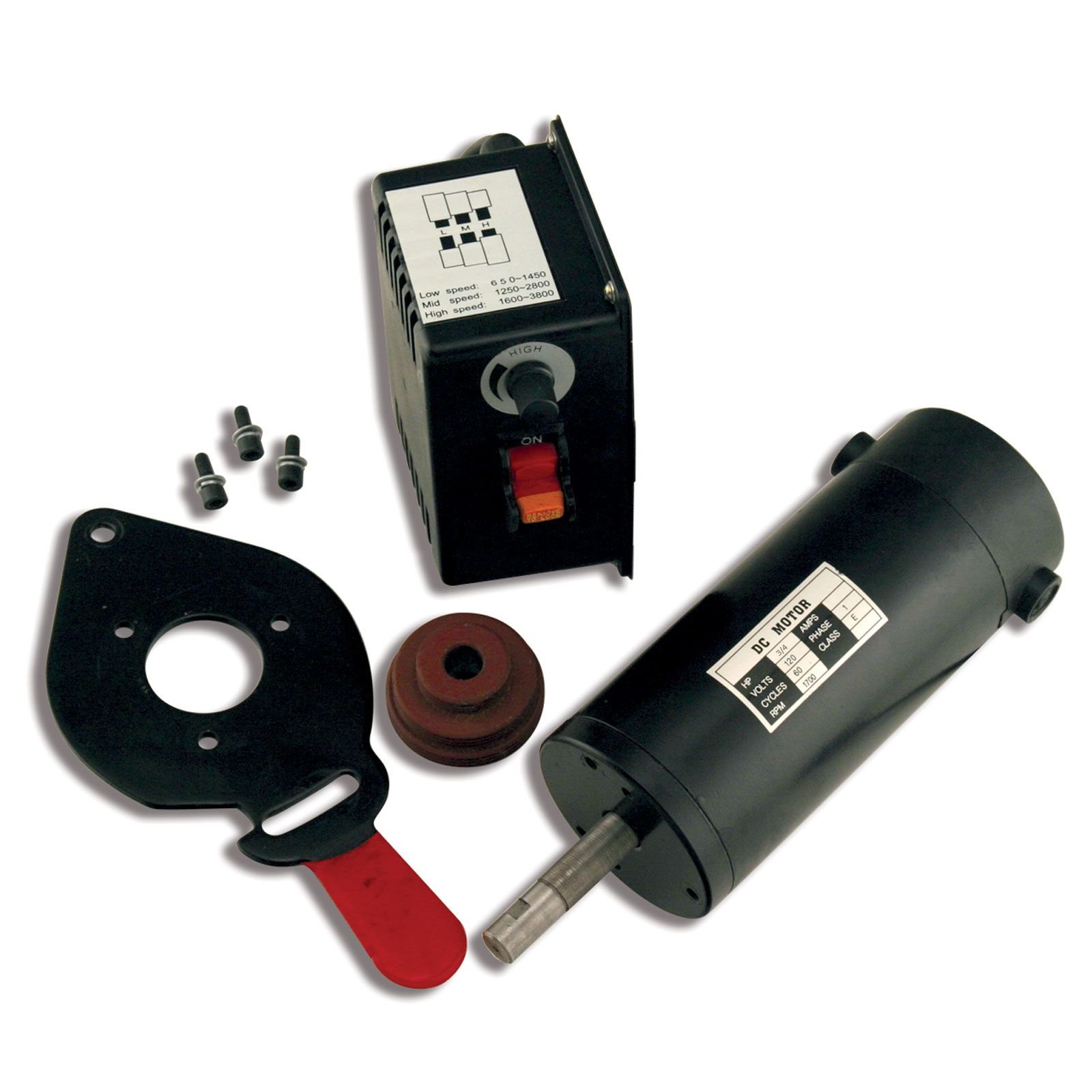

I run a sharpening business in Vancouver. The Viel machine (made in Quebec) sold by Lee Valley and others (i.e. Elite Tools) is a mainstay of many commercial sharpeners. A popular upgrade, which I just did, is modifying it with a VFD motor intended for a pen lathe from PSI Industries.

Is this the motor kit from PSI?
Yes, that's the one. Unfortunately they don't ship that product to Canada. Had to bribe someone to ship it to me from the US...
