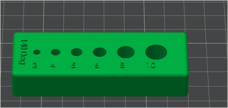

(Bambu A1) Any idea why its not printing my extruded text? Blue = cad model (0.8mm high). Green = what Bambu sees on initial load. But when I slice it & Preview it becoms flat top (red). And thats also how it printed physically.

I'm not seeing that. This is sketch text, exploded, then extruded 0.8mm. As you can see there are four layers of text after slicing. How are you generating the extrusion?
Maybe a Solidworks thing? Its just a plain vanilla font. I increased size to 14 pt just now as a second test but the physical size should be sufficiently larger than the 0.2 step resolution. It looks correctly extruded & I confirmed its adding it onto the main block body. My point is that within Bambu Studio the initial green preview (prepare step) shows the STL just like the SW CAD file just fine. But when I invoke Slice, it planes the text off (red). And that's how it physically prints

Good stuff, John. FYI specific to my original raised text issue, sorry I ended up dealing with it off line & should have closed the loop here It had nothing to do with my cad model or text size or any thing like that. It simply required a setting tweak inside Bambu Studio slicer whereas I was using entirely default settings at that point. Easily resolved once you know what setting to twiddle. I can't say if this has parallels to other slicer apps or different parameter terminology. My exposure is confined to Studio & not much of that. But another nice thing is if you have a collection of settings that work for certain kinds of models, you can save that as a named preference & just use it again or as a starting point to further tune. I've watched some videos of very simple parts but have say certain angles. Once you see a single layer greatly magnified it makes perfect sense why it just cant squirt something out poorly supported or out in space. Then the settings or orientations or support start to make sense. But this is also where judgement & experience probably comes into play. Fortunately there are good resources out there.
