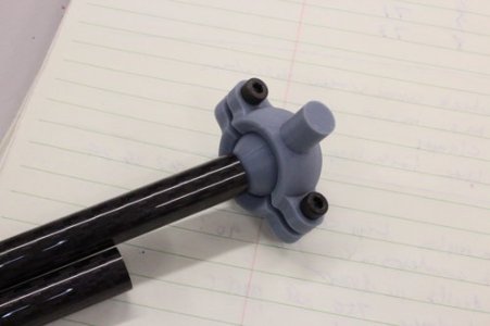

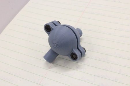

Ball & Socket
Just messing around. I have some forthcoming articulating arm projects coming up so made a tester. The ball is 20mm diameter. Stem is 10mm OD to fit a CF tube ID. The lugs hold M4 screws which grip the ball amazingly well, maybe the 3DP striations help a bit. I probably will increase the infill density on final print to give it some strength, but so far so good. I've seen some online models where a knurled nut squeezes down on the socket but that involves threads & whatnot.

Very cool. I was looking for similar awhile ago. Can you post the Stl or model Peter.
Here you go. usually I print from .STEP but assume .STL is good enough? I'll probably be modifying this for purpose, but will give you something to fidget with in the mean time
Cool. I just bought some large steel balls to make a bunch of universal welding/fab table fixtures, and I like your socket design much better than what I was going to do....I may have to take some inspiration from it.....
