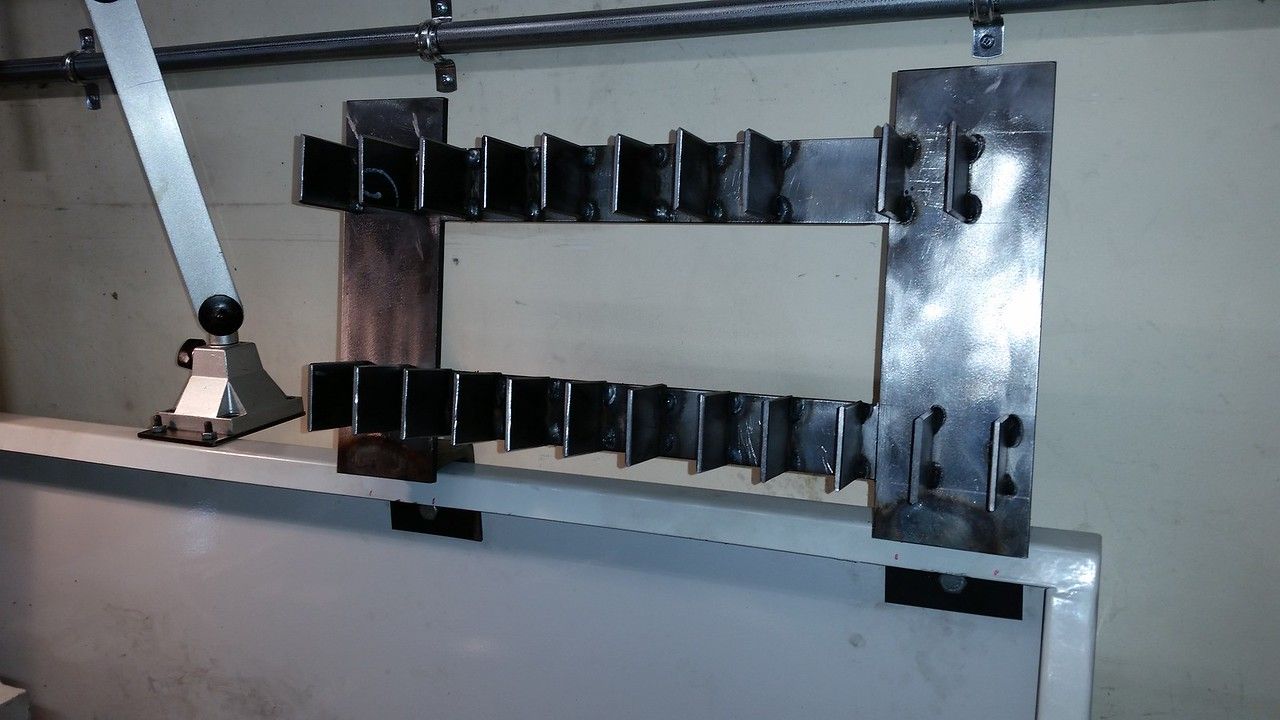

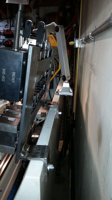

Hey Scott,
Here are a couple of pics that show the design of the tool holder rack.
I have found the hockey puck feet to be just fine and the level has not changed.
Most of the observations and changes I have made are in the post.
https://canadianhobbymetalworkers.c...s-or-a-pm1440hd-from-precision-matthews.1229/
