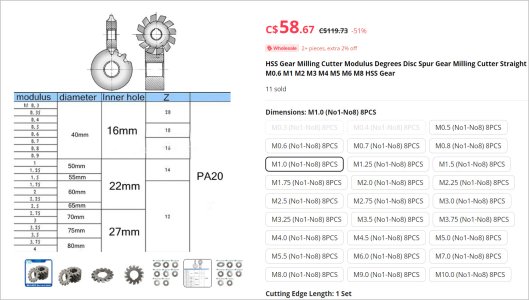

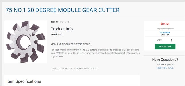

I intend to make some metric spur gears. Looks like lots of selection on cutter sets but for some reason, I don't see many matching arbors unless I'm looking in the wrong places. For the module series I'm interested in, nominal cutter hole ID is 16 & 22mm. Not sure about the key width yet but I'm sure the info is out there. I see plain arbors (no key) for slitting saws. I see shell end mill arbors with 2 key way tangs vs a single. Maybe the idea is you unscrew a tang to make it a single? Or what am I missing in the description? They don't look difficult to make but OTOH could be hardened & I wanted to see what commercial options are out there. I have R8 spindle but straight shank would be OK too.

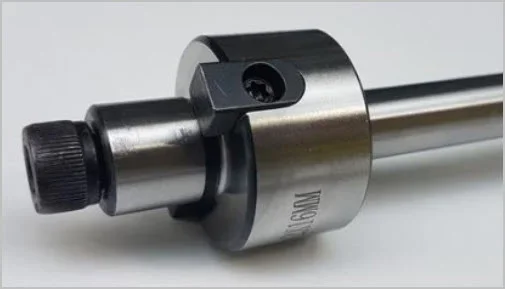

This is what I have coming.
ARMYJY 22mm R8 Shank Milling Arbor Gear Milling Cutter Holder Toolholding 7/16-20 for 22mm Gear Cutter or Other Milling Cutter https://a.co/d/f80b9G0
Thanks. That looks right. I have the imperial version of that with the stack of spacers. I think it was for slotting mills but same single key principle.

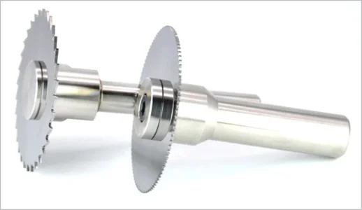

This week I have to do a simple slit cut on some custom marine bolt (sleeves). The cutter came in with a key, but the arbor is an R8, no key. I will take it easy on the cut, as it is stainless.
You would need the Key for your application I would think...
@David_R8 when you were looking around, were you able to determine the corresponding key width? I assume it must be standardized to nominal arbor diameter, but who knows, maybe gear cutters are different?

Oddly I found no reference to key width so my fingers are crossed.

As you note, the arbour you showed in your photo is a shell milling arbour. Some of the older face shells had different size dog slots. Easy to make dogs the size you need though.

Slitting saw arbors are different again. They typically have low clearance at the end so they can get in close to the work.

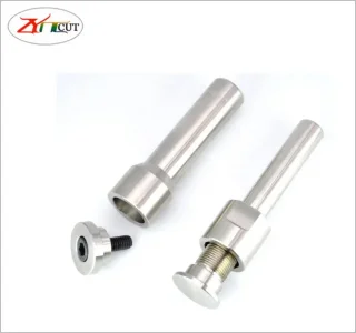

Speaking of saw arbors, I'll have to check the ones I got off Ali. They are low profile & very well made. I have standardized on metric saws. But I suspect the engagement part for saws may not be quite enough for gear cutter thickness and/or mismatched body diameter.

Those look very nice Peter.
Two styles, one with a washer + screw bottom retainer, the other with a reverse thread top nut. Reasonably priced for quality. There are some nutso expensive USA & Euro ones out there. Maybe intended for industrial saws & applications, not sure.
