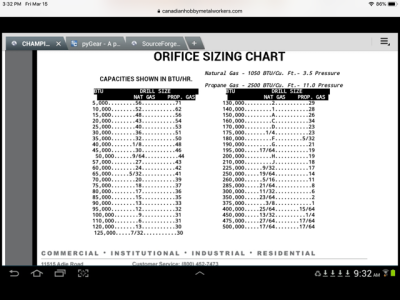

My propane metal melting forge fournace was damaged when we moved and I was thinking of building a new one. Instead of propane using natural gas?
I'm using nat gas now. And @David is correct. You have to change the jet size. I can't find the files or information on what I did.
One thing to keep in mind, in the old days the gas pressure after the house meter/regulator was pretty low. Now it's around 2 or 3 PSI and BBQs use about 0.7 PSI. The propane foundries tend to run at least 10-15 PSI IIRC. BBQs drop the pressure down to 0.7 PSI again IIRC.
The burn temperature of natural gas and propane is very close, like withen 100f, i think the low pressure is why you would need that larger jet
edit ; found it, the btu content is considerably lower in natural gas that's the reason it seems "colder", 2500btu per cu/ft of propane, 1050btu per cu/ft of natural gas, so you are going to burn 2.5x the natural gas to get the same energy output as propane, probably still considerably cheaper though

Here’s a chart for you

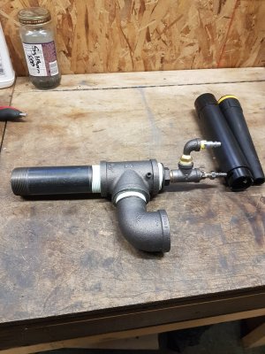

I do use gravity fed drip injection type waste oil burners in my furnaces. Mine are loosely based on Lionel Oliver's Brute and Hot Shot burner designs (https://backyardmetalcasting.com/oilburners10.html)
Lionel was the man behind the old alloyavenue forums which are no more, but his personal website is still up... For the time being.
These burners require forced air and a preheated furnace to vaporize oil drips that get blown into the furnace. For this reason they also work as forced air propane burners.

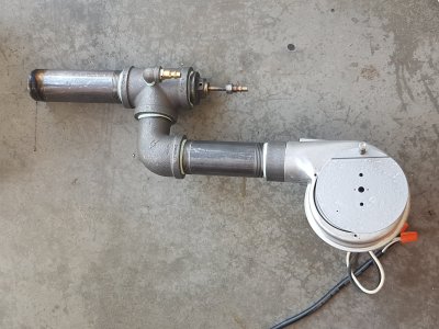

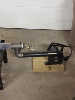

My small low mass furnace heats up so fast it almost seems silly to drag out the bigger blower and set up the oil tank and line etc., so usually I just run it as a propane furnace using about 5psi of propane with a hair dryer for the forced air. Ideal for one and done melts starting from cold.
But for bigger melts or when I have to do back to back melts, I use a heavier duty furnace with a 5 gallon bucket shop vac power head blower and switch over to a waste oil drip controlled by a needle valve once the propane gets the furnace glowing hot inside. This preheat takes about 2/3 as long as a full melt from cold in the small furnace, then I can start the oil drip and really get going. So with the additional thermal mass of it plus it's larger size it's a lot slower to get the first melt done, but after that it really rips. That is also the setup I'll be using for my upcoming first cast iron attempt, since an oil burner can get you there easier than propane. Although I'll probably use diesel and not waste oil. It'll burn waste motor oil or waste cooking oil (or jet-A, kerosene, whatever) just fine once the furnace is hot, but diesel is pretty darn convenient.

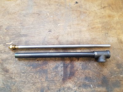

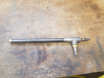

Ignore the incomplete one on the bottom of the pic for now. The smaller one above it has served me well since 2015. The oil line quick connects into the very back end of the burner and runs through a thin central tube (seen in the one you're ignoring, but hidden inside the 1" burner tube of the one you're looking at) to the very end of the burner tube. Air (and propane, during preheat) get sent through the 1" tube through a line that is hidden on the underside of the tee in this pic. There is no jet, just a 1/4" npt fitting that dumps gas into the tube (there's a 0-10 psi adjustable regulator on the gas line, more than enough gas to preheat the big furnace for waste oil or take 30# of bronze to pouring temp in 25 minutes in the little one. And there's a ball valve to.quickly cut off the gas if needed. The largest tube on the outside is just a sleeve to hold it centered at the correct depth in my furnace tuyere. The gap between it and the 1" tube is stuffed with kaowool to keep flames from blowing back out toward the fuel lines and valves between the 2 tubes.
Simple as can be. No need to run compressed air to run a siphon nozzle, no complicated nozzles to clog up on you if your oil isn't so well filtered. I do have to blow a few french fry crumbs out of the needle valve every so often.

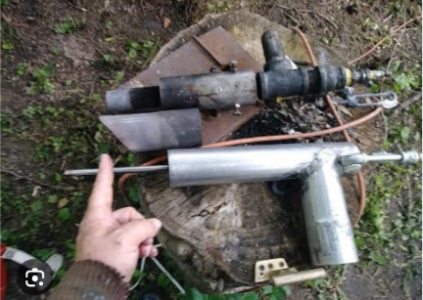

The siphon nozzle option has its advantages too like not needing any preheat to light and needing less adjusting mid-melt to maintain tune. Delevan is the name of the company that makes the nozzles. You also need an adaptor that goes with it. Similar to nozzles used in home heating oil burners, but those use a fuel pump not a siphon and they won't like waste oil. You could build a pumped diesel-only burner with one of those though.
The Kwiky All Fuel Burner is a popular homemade oil burner that uses a diy.siphon nozzle. Many backyard metal casters have vouched for it, so that might be another option:
