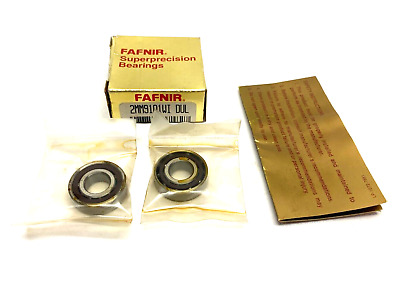

I'm looking for a matched pair of angular contact bearings. Typical deep groove bearings in this size have about 0.002" of play laterally even when snugged up and the same applies to angular contact bearings if you don't order them as a matched set, the matched sets are precision ground so that when preloaded, the outer and inner rings have the same width resulting in near zero end play. Matched sets can be very expensive.
I was able to find a pair of matched NSK's and they allowed me to get the total error on the X axis of my mill down to 0.0003", and I'm happy with that goal was < 0.001"
Now I need another set for another axis and found these old stock on ebay. They appear to be a matched set (same box), but I'm not sure they might just be two unmatched. I asked the seller and he has no clue. I tried to find details online but no luck.
Does anyone have any insight?

Most likely the set in the eBay listing are a matched set, but the seller isn't sure and I don't want to spend $100 to get an unmatched (useless to me) set. I found another set that are definitely matched for US$65 with free shipping and they are on the way. The listing above from Bearings Canada is $450 before tax and shipping , seems a bit over the top for a couple of small P4 bearings. I can swallow $100 to get under 0.001", but more than that just seems excessive.

What you get with matched pairs is the right preload ground in. P4 AC's "universally matched" should be <100. That's the only difference. You can achieve the same thing with universals and grinding spacers (done it a few times)
Bearings are really really good nowadays. The big brands have got them dialed in to perfection and their manufacture is highly automated. Great news for us because most of them are excellent, at least from a recognized brand. And cheap (unless you want matched).
I have had this from first hand conversations with engineers at two of the major bearing companies: The higher cost of the P4's (and presumable P2's) is the time it takes to check and certify them. They all come out of the same pile of produced bearings. Now, there is a chance the one that is grabbed and inspected for P4 status gets rejected, but these engineers advised that doesn't happen much because production is so automated and dialed in.
Finally, you can expect a similar level of very small variation with the preload of "universal" P4 AC's. Non-matched, called universally matched, do still have a preload. You don't have to precision grind spacers, you can just assemble the universals and they will be very very good, maybe as good as matched. You can't guarantee they'll be as good and you can't specify or control the preload like you can with matched, but they will be awfully bloody good.
They sort of prey on the end user; the OEM price on those expensive bearings are 1/4-1/3 of what you see listed. At that level it becomes somewhat more reasonable to choose matched sets for convenience and certainty of the fit.
