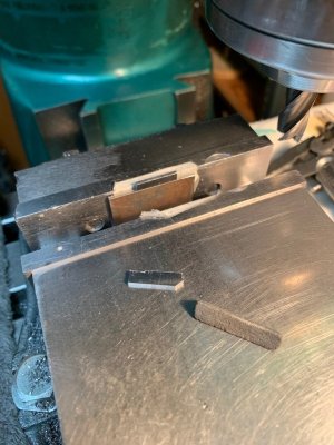

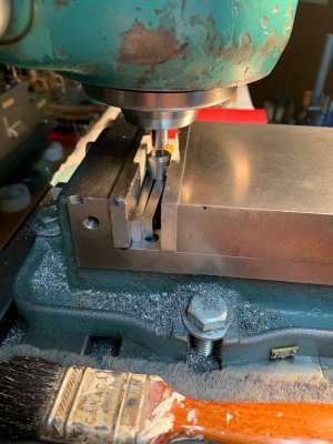

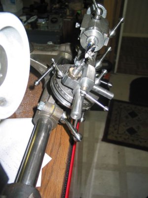

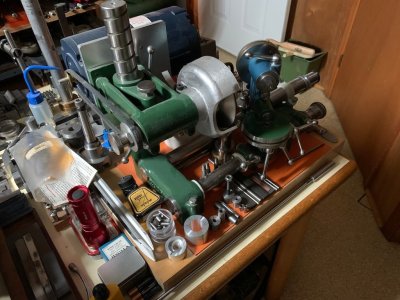

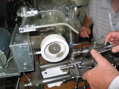

Hi All,
Working through the last issue.
Again, a lot of the time and effort involved is the preparation work and this time it is no different.
One first has to partially dismantle the tool workhead from the rest of the Quorn and this is no small fiddle. No photos were taken of this.

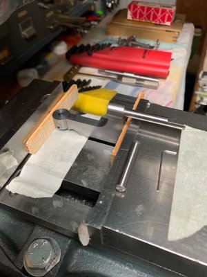

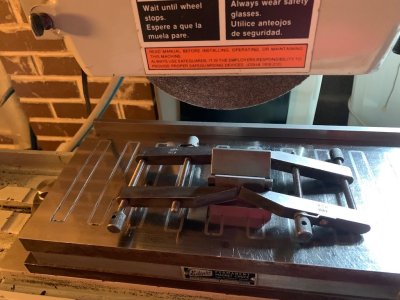

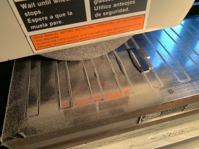

Next, I needed to grind the top of the milling machine vise jaws dead level and equal in height. See photo 222. One has to do this periodically anyway so this was the opportunity.

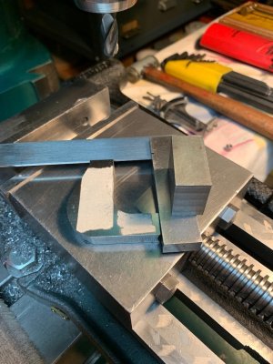

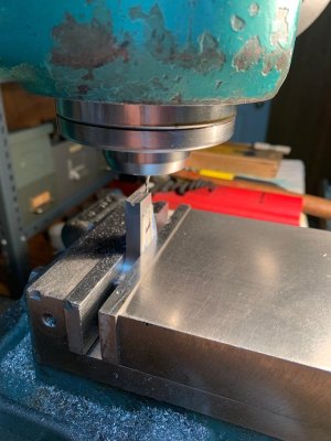

Next, was to set the main bore of the tool holder boss square when the tool holder base assembly rested on top of the SG milling machine vise jaws as seen in photo 223. A couple of SG spacers needed to be made as well which were dead parallel and square themselves for this setup.

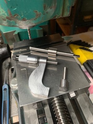

Next, was to precisely locate and center the base bore in the tool holder casting which was achieved using a collet in the spindle of the mill and a straight ground, on size rod. This would be greatly facilitated if the base bore was dead square to the spindle of the mill, hence the need to grind the top of the jaws of the mill vise to achieve this. Photo 224. It goes without saying that the spindle of the mill also needs to be trammed square to the table of the mill.

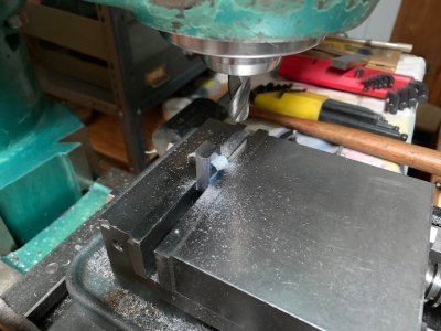

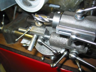

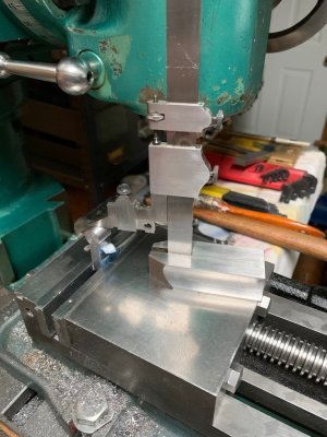

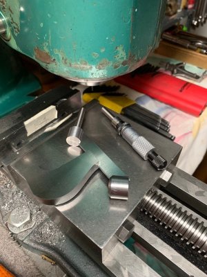

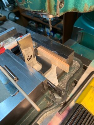

The next operation was to actually cut some metal. The vertical cutout - radial clearance for the radius setting micrometer was achieved through careful plunge milling with a new 9/16" diameter center cutting end mill held in a collet after which the inner face of the tool holder mounting boss was milled square to the bore of the boss as seen in photo 225. This was done as a single (combined) operation.

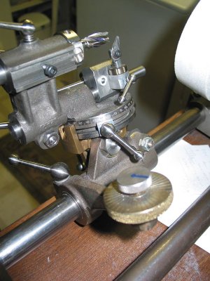

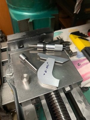

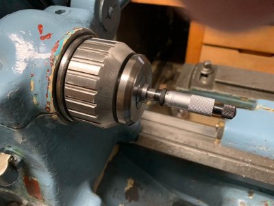

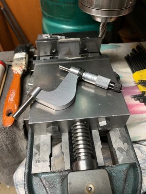

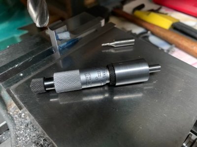

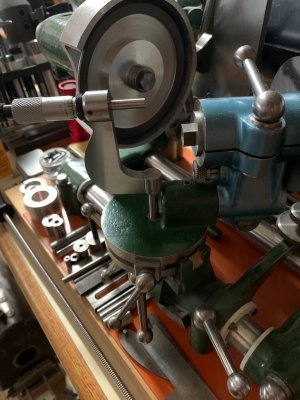

And there it is, photos 226, 227. The radius gauge sits marginally below the centreline of any tool held in the tool holder (in its highest position) which is what I want as the entire radius gauge
assembly can now be raised or lowered slightly to match centre line to centre line to any degree of accuracy needed.
223 Setting the Main Bore in the Tool Holder Square.jpg224 Centering the Toolholder Base Bore.jpg225 Milling the Inner Face of the Tool Holder Square to the Bore.jpg226 The Radius Setting Micrometer Fixture Set in Place on the Tool Holder.jpg227 The Radius Setting Micrometer Fixture on the Quorn.jpg
