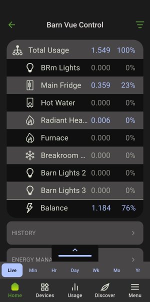

Here is my shop RIGHT NOW at 4 am. I can simply login to my energy monitor and know what is using what.
These amp meters are located in my breaker box, but I also have a number of individual sensors that can measure individual devices that are accessed via the devices tab at the bottom left. Because they collect data, I can get cumulative and seasonal data.
I don't get power factor data, but I can get that when and if needed.

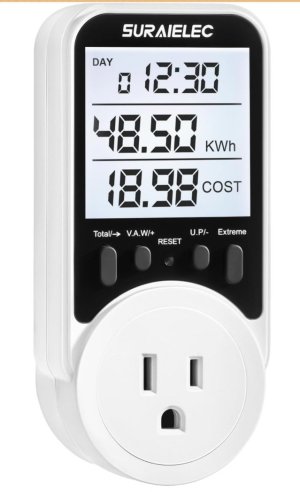

The little device that @CWret bought (ya, I later bought one too) is circuit specific - you plug it into an outlet and then plug the device into it, but it gives you instantaneous information.

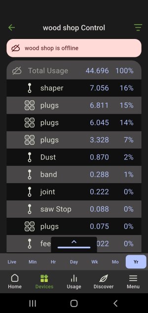

This is the system I installed in my friend Dave's shop to work out starting sequences and maximum concurrent machine operations.
Why you ask do we need that? He is going to install PV solar system and most solar inverters operate just like the inverters in a VFD, they han't handle inrush current well.
This home has a deep well pump, and a geothermal heat pump with a 5 1/2 ton compressor, and all the machines. I'm designing a system that does not use the typical Chinese inverters that are all running on high-frequency based IGBTs or MOSFETS but rather iron cored transformers to be able to absorb inrush currents for more than 1/2 second.
The equipment options are severely limited... or like Schneider, all commercial and too costly

Your power monitoring looks almost identical to mine. I assume it's an Emporia system too. Mine is currently configured for tax calculations. But it's easy to reconfigure.
I doubt it will handle stuff like In rush. Hence my resistor or cable coil and scope suggestion.
