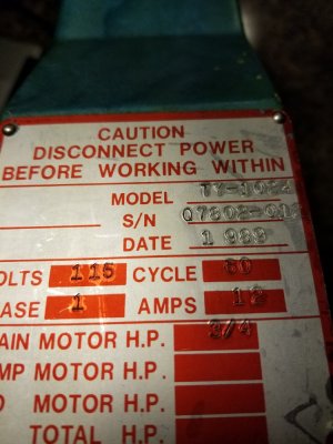

An orphan Lathe labelled only TY-1024
Need some more pics of the overall bed & other more distinguishing pictures. I tried Googling '1989 TY-1024' & several hits of a Jet 1024 came up

Basically Taiwan lathes of this era came under a multitude of names. Jet was one of the common (USA) importers. Depending on the paint & 2$ sticker, some are identical, some mostly the same, some are slightly different. The devil is in the details. Parts wise you are probably SOL unless you can find a donor (and I did stumble on a few looking).

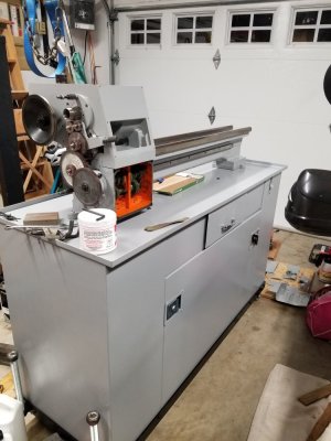

Nice resto work in progress BTW!

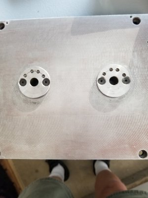

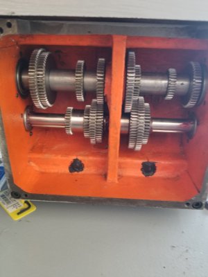

No sight glasses, and unlike the Jet, this one has a 4 position alpha control knob and a 4 position numeric knob making it a 16 speed qc box.

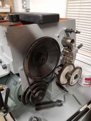

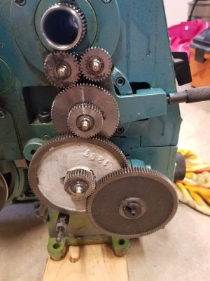

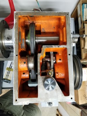

From the pictures it looks like the spindle is belt driven. There is a gear arrangement in the headstock that I take to be back gears.
Based on the picture in post #17 of the QCGB, this lathe seems to have “rotary knobs” to change the gears.
That is correct. The lever goes on top once the cover is in place. Not the cleverest cover design I might add. I am going to put my gear train into an oil bath instead of loading them with grease. Hope to make the headstock a little quieter.
yes. The spindle has a stout V belt that is presently riding deep in the V. If it fails or there is no slack left to adjust out the spindle will have to be pulled. Alternatively I could use a Fenner link belt if the group send some positive feedback. There is a high and low range.
Although I haven't yet used a link belt myself all that I have heard about them has been positive. I sure would not dismantle the spindle/headstock just for a belt replacement.
