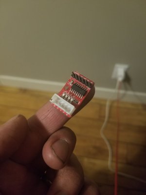

Kyle I don't believe you can drive a stepper with an arduino uno. But there are some arduino boards with an integrated stepper motor driver. This is a tiny stepper motor driver that you need in between your arduino uno and the stepper motor. Keep in mind this is too small do be useful for machining.

I should go on to say I am interested in learning about the same thing that Brian is asking about but I have no experience in these things.

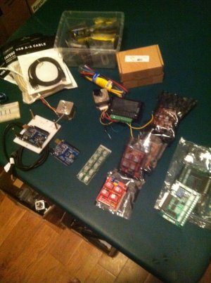

Hopefully I have several of everything, and different kinds as well (Old and New). that's probably a lot of my problems. I'm not sure what goes with what or is it software that's lacking.
The motors are no bigger that a roll of Scotch Tape.

Brian do you have something like this in your pile of stuff?

The red pcb that’s still in its plastic wrapper looks like a stepper driver shield that’s good for <2 amps. It plugs into the top of a UNO. It also needs a separate power supply to drive the steppers. Then it’s just a matter of wiring it up and getting whatever software you’re using to work.
I didn’t look but there should be some simple stepper sketches on the web. In any case, there are only 3 signals from the UNO to the shield that matter. Enable, Direction, and Step. The EN is held either high or low, I don’t recall which to enable the driver. For testing Dir can be either high or low. Step is just a series of pulses that drives the stepper. One pulse every millisecond should work

Sorry for the delay. here's more pictures of what was in the first pictures.
IMG_1002[1].JPG IMG_0995.JPG the older style driver (I think this driver can go up to 5A )and board with lpt1 port (RS232).
These next 4 pics are another system. the Uno board, Controller board, & driver chips, All three put together, and finally a top view of all three put together.
The motors are a whopping 0.9A.
I have wired them like Johns' picture, but Nothing. Did I blow something playing with it? Can they be tested?
