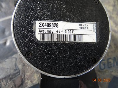

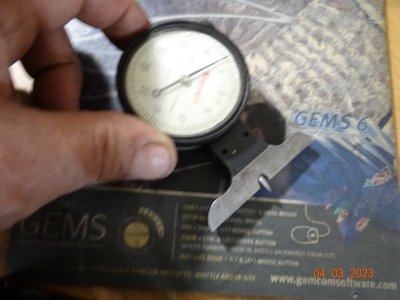

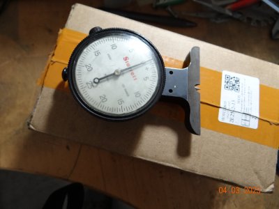

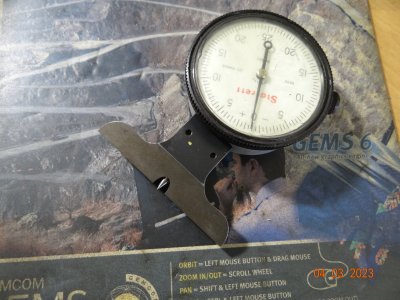

Alright, what is this doodad?
Ironman
I got this in another pile of Starret stuff, and I know it is not a wall hanging. Have any ideas?

Looks sort of like a durometer tester, but without the right base. There is a starrett product number behind the needle. I can read NoX643 or NoX043. The last digit is hiding in the pictures you posted.
EDIT: Looks like is just No. 643, Starrett just calls it a depth gauge:
Dial depth gauges with measuring rods are positioned over holes and the graduated blade/scale is lowered until it contacts the bottom of the hole. They have a dial gauge fixed to the frame that displays the reading. Depth gauges with a single fixed rod or plunger are for short measuring ranges, and interchangeable rods are used for deeper holes and larger ranges. They are commonly used to determine depth-of-groove and feature measurements.
