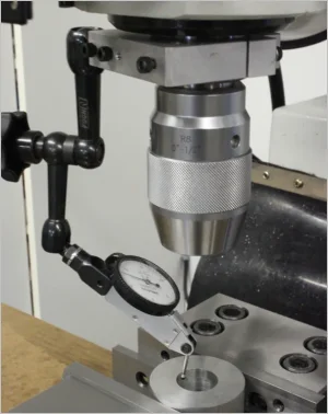

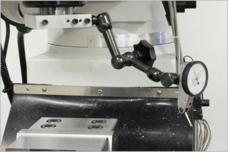

Here is a DTI (dial test indicator) for you @PeterT . They don't have great accessibility.

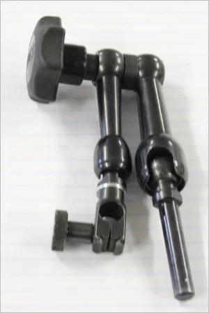

What you need is a Noga arm. The one I have has a plain shank end which goes into the drill chuck or collet or whatever. Or as shown, adapted to a quill clamp so you don't have to disturb any mounted parts or in-situ tooling to do indicating. This clamp was a prototype to allow the shank to be placed vertically or horizontally, but I want to make one more like the open C shape with a single tightener. Anyways, it takes about 3 seconds to have the DTI ball on a surface ready to rotate. I would argue the DTI can go places the Blake cannot because the Blake indicator arms are bent a certain way & limited in span. This is the short Noga, my vise is 5" for reference.
I bought mine for re-boring pulleys. I was rebuilding several machines, and I had to bore out some pulleys. These were used pulleys, and the bore wasn't very pretty. I could reach all the way to the bottom of the pulley to find good parts of the bore.
It is also a lot faster to use, if you get the hang of it. You aren't craning your neck or using a mirror to see the dial when it is facing away from the operator.
One other way it shines is when you are indicating on the outside of a large circular object. It can be done with a DTI and a flexible arm, but there is quite a range the coax is faster and more convenient. But only once or twice a year (for me, anyway)
- This sounds like I'm a big fan. I'm not, really. The few times it is needed it is a blessing. Otherwise I reach for my Mit DTI (I'm not an animal!) :eek: - I got mine for 75$ and for that price it is well worth it.

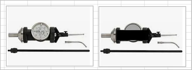

But it's not obvious to me what you want to evaluate with the Coax. Can you describe the test you want to do in more detail?
Just the 'inverted test' with an indicator arm screwed in. (Left) chuck the coax on its stem in the lathe, zero the dial. Then (right) rotate chuck 180-deg & record any needle movement, likely require a mirror.
Gotcha. Basically keep the axis or rotation on the lathe spindle axis but invert the indicator so the reading is at the back.
I had thought maybe you meant on a vertical axis like your DTI example.
Hopefully, I'll get to it later today. But we have company coming for new years so I have a honeydo list. So it may end up being tomorrow.
