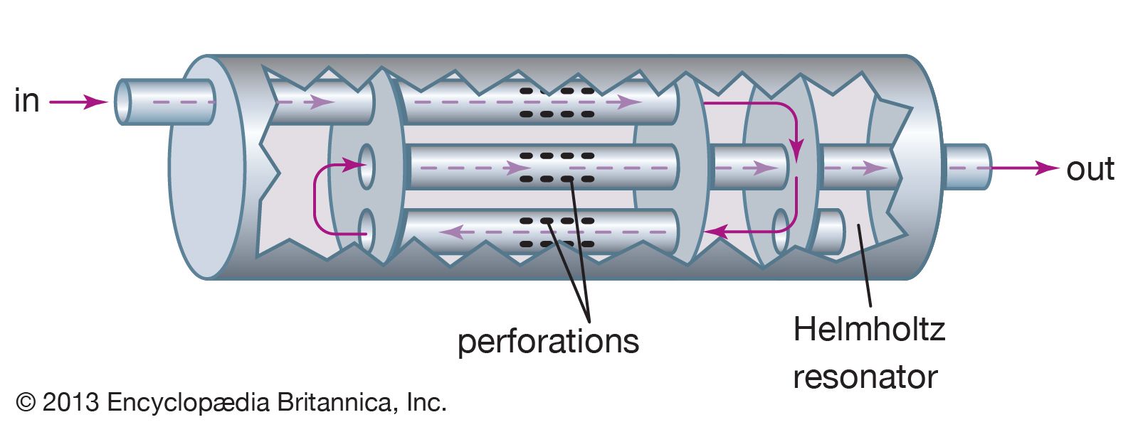

Has anyone added an intake muffler/filter their compressor to lower the noise?
At one shop i worked at, they had a compressor with a regular car muffler on the intake, with the intake piped through the wall. It was very quiet.

Hmmm I wonder if a small engine muffler would work?
One thing that greatly reduces noise is sound isolator pads under the compressor and bolting it down. Basically this damps any vibration running through the machine being amplified through the tank (think nice big bass speaker).
I think the muffler idea would need something that is internally baffled...
Without some reflective surface, the pulses wouldn't interact with each other
Looking at (not actually watching) the thumbnail David posted, that big stainless can is offset an inlet/outlet design. Which is why it would work.

He does comment that it's a straight through design so likely would be quieter with something that had more baffles.
I worked in many areas of vehicle R&D but never in the Muffler and catalyst group. However, I did work in engine design which included intake and exhaust manifolds.
About all I can add is that flow restrictions are important. The general idea is to limit air column pulsing at the frequency of engine (compressor) operation but not restrict the overall air flow rate. Small orifices, small tubes, lots of bends, and direction changes all restrict air flow. Because the frequency is sensitive to the length of the tubes, they used to sell variable frequency mufflers. Perhaps something like that could be used to dampen the noise without affecting performance?
Whatever you end up doing, I think it would be interesting to measure the time it takes to reach a given pressure differential with and without the muffler. The more noise suppression you can get without affecting the time, the better.
