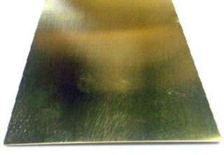

I’ll add that you can get K&S brand brass sheet and strip in various thicknesses from .005” to .064” at hobby stores. Usually they’ll have a rack with an assortment.
That was the cheapest and easiest way for me to get the brass shim I needed for the gibs on my mill.

Yup, I’ve found that most hobby stores carry the K&S stuff. I bought the .025” brass strip I needed at Skycraft Hobbies in Burlington.
You can find some of the K&S stuff on Amazon as well.
