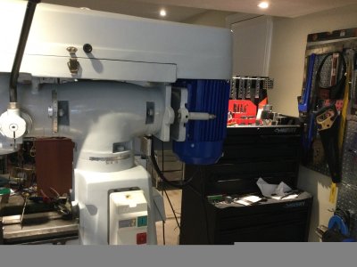

FWIW,
I converted both my old and latest mill to VFD. The blue motor is what I'm using on the latest one 1.5HP. Paid $113 for it from Lenmark. Sold the old original one for $100. So upgrade cost was negligible. If you keep your eyes peeled these 1.5-2HP motors sell for peanuts. Smooth and quiet Variable speed - priceless
FWIW,
