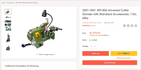

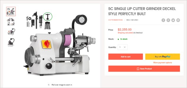

We may have discussed this elsewhere but thought I would pass on a comment about the 2 TCG's which Accusize sells. Their slightly different description of the (new) 5C model caught my attention so I called them to inquire. It turns out that the 5C is not an upgraded machine vs the R8 in any fundamental way. Both comes from the same manufacturer. The price spread seems to have more to do with the accessory package included with 5C model. Anyway, if you have a certain collet collection, at least you have options in Canada which wasn't there before. Shars has carried the 5C for some time. I have seen work heads available separately on Ali which I assume but I couldn't get them to commit to whether it was R8, 5C or older U-style collet used on original Deckel.

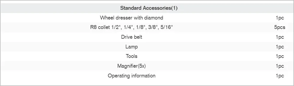

Accusize MY-30A (anR8 collet work head)
Accusize Single lip cutter grinder (5C collet work head)

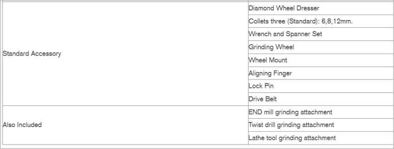

Finally, we thought we had better offer a small universal and single lip cutter grinder. Our research found that the CM-U35C Single Lip Grinder is the best machine of its class out there, and is good for almost anything in the right hands.
Also goes under name of CutterMaster (note the same description verbiage)

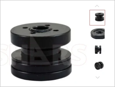

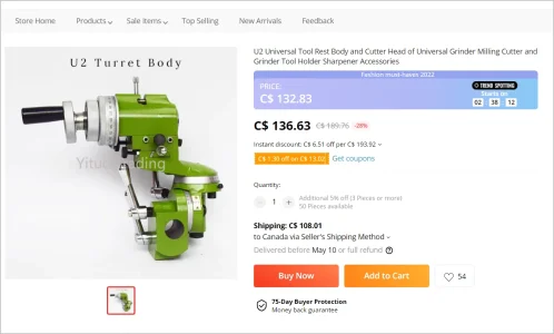

Don't know much about your particular grinder but this is the sort of work head I was mentioning. Its providing the 6 or 7 degrees of rotation/adjustment. This is an old ad so you will have to search afresh. They are on Ebay too. Pretty decent value if you had to build from scratch. But on closer inspection they are a it of 'kit' begging for improvements. I hope you have better luck pinning them down on what collet the spindle is. They use the word U2 kind of loosely. I've seen U2 & R8 in the same description. Maybe they mean 'U2 style' cutter but R8 collet. 5C heads are rarer for some reason. Accusize didn't seem to have much interest in bringing in a work head separately at the time. Sidenote, I mentioned in conversation it would be nice f they carried the wheel adapters (which Shars carried). They didn't seem to be aware that was a desirable thing, but at least they are listening.
