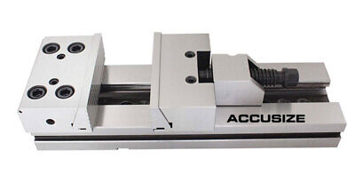

For anyone looking for a premium vise, this might be an option. From the photo and description it appears to be a clone of a GS (Gerardi SPA or some say Gerardi Sowa).
Accusize Industrial Tools 6 Inch x 8 Inch x 2 Inch Vise https://a.co/d/4iEGEPv

The jaw function on these vises has to be seen to believed. I got a Genuine Gerardi SPA vise with my Hartford Mill. The seller had no idea what they were giving me. Even worse, I had no idea what I was getting! In time, I came to know that the vise was probably worth almost as much as the mill!
I bought new jaws for mine from Sowa through Varco. It is good as new now. I have used mine extensively now. I absolutely love it!
If it isn't obvious, there is no need to tap down the work as the prismatic jaws pull the work down as they tighten. And it's very low profile too!
The 4 tenths spec is for dual vises - ie a vice to vise tolerance. I think the vise itself is well under that. Anything I have ever done with mine didn't produce a difference I could measure. It was also easy to tram.
I can't vouch for this one, but I can vouch for mine. It is awesome! If I didn't have one but knew what they were like, I'd be getting one to try.

The vise might seem expensive - especially sold through Accusize - but like some of the other stuff sold by accusize, it is made in Canada not in China. Best of all, bought through Amazon, it can be returned if you end up thinking it wasn't worth the money.
For reference, here is the same model Sowa GS at $1400 Cdn
I am very doubtful the Accusize vise is made in Canada. I would wager made in China, where the bulk of their goods come from. Not that its necessarily bad, but just saying. One might stand a better chance that Accusize, a Canadian 'distributer', stands behind their product better than others. But FWIW, there are lots of examples of Chinese versions of the Gerardi/Bison vise which are hopelessly worse than the quoted specs.

Just b/c the name sounds "American" does not mean most of the time it is American.
It is clearly the same vise as from Aliexpress. You can always ask on Amazon, Accusize, where the vise is made.
You can see on Amazon page they list "date first available" as 2013 ===> clearly China.
Finally Accusize lists same item on eBay and lists country of origin as CHINA
