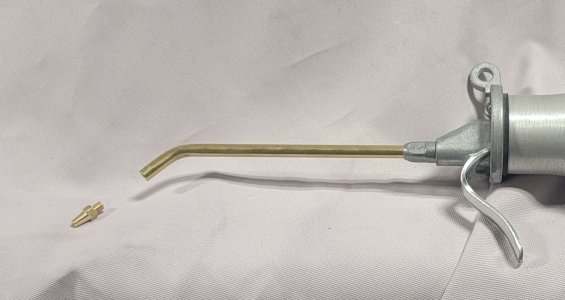

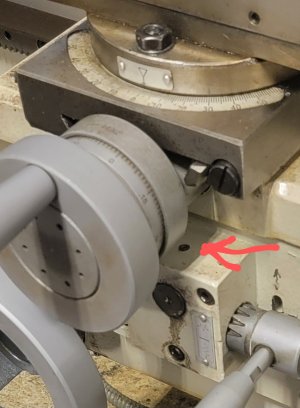

Here is my problem.
This ball oiler on my lathe has been impossible to use. I can't get a ball oiler tip in there to oil it.
I need to make a right angle adapter for one of my oil cans to fit it.
I have a really nice Reiling Oil can that would perfect for this job. In fact, even with the right angle adapter permanently installed, it would fit all my other ball oil fittings.

Edit - The tip is 4.5mm 0.75
Part of me wants to make a 90 deg adapter, and part of me wants to make a new 90 deg oiler tip.
Thoughts?
Here is a project for you to solve the problem of the “dribble”: relocate the oiler to the side (for example) and cross-drill a passage way to feed the original oil gallery. Close off the original oiler port with a plug.
Deckel engineers were/are huge fans of this system. Works very well and is super convenient for central oiling systems. Plugged off cross-drilled passages are all over the Deckel FP3L saddle. Very ingenious (and complicated)…
Very nice. Lotta work, but very nice. Lemme think about it.
Same design as mine. I missed my opportunity when the carriage was off the lathe to replace the 'never took a sip of oil' fitting with a right angle snorkel. Or maybe drill a new passage at an angle & hope you hit the existing vertical gallery hole.

I have been thinking about mine ever since I read @RobinHood's suggestion. Seems like a few of us have this issue.
Rudy's idea won't work directly on mine because there is a screw in the way. I thought about removing the screw and drilling anyway in the hopes that oil would just flow around the screw shaft but it's a micky mouse solution. Then I turned my attention to the left side and had similar problems.
Right now, I'm investigating an extension of Rudy's idea picking up on his comments about internal Plugs. If I drill through the right screw hole with a small drill first, then a larger drill, I could put a plug in behind the screw shaft (or even just leave it unplugged), then drill vertically to intersect the horizontal screw hole, and then install a new ball oiler where it is accessible. A little extra oil dead ended in a screw hole won't hurt anything.
I think this is one of those problems that is gunna sit and simmer a while. Oiling my shifter shaft the way I have has worked for many years and it will work for many more. I am gunna sit and noodle it till the idea stops improving. Then I'll go do it. Hopefully by then my bride isn't following me around all day.
In the meantime, I may or may not make a new oiler tip to reach the current fitting.

Your sketch is pretty much exactly what I had in mind. Most offshore machines have pressed in ball oilers like these. The only tricky bit is safely extracting them without creating issues, which means clear line of sight without the dial or whatever in the way. You don't want to push the oiler into the port hole & some are actually a straight hole without no counterbore ledge. Worse, you also don't want to inadvertently drive the steel ball out the bottom & now its stuck somewhere in the gallery 3" into the casting. On one of mine I bent the lip up all around the periphery. The ball came out topside and (most of) the spring. Then I had some brass cage material to grip with pliers. I've also heard others use a tap to thread an ID grip & tug.
Anyways you could make the horizontal section that @Darren shows 'new oil port' so it also captured an oiler body if you needed to feed it from the side. I like those 1-shot oiler tubes you see on mills but I believe they are all threaded fittings. Probably a bit unsightly on a typical lathe but might be another way to get lubrication into hard to reach 'afterthoght' areas.

Could you just leave the current oil port in place and drill a new passage, from either side just under the screw? It would intersect the same shaft bore as the original. In your first pic, is that the end of the shaft that is bare metal color or is it a plug pressed into the bore?
Yes, I prolly could. If I go that route, I'll prolly try to lube around the screw shaft using the screw hole as part of the oil galley. Depending on the clearance, I might have to open the screw hole a bit so the oil can flow around the screw shaft.
I'm not sure which one you mean John. But it doesn't matter. Either one gets the same answer. One is a mounting screw and the other is the shift fork shaft. The shift fork shaft is splined and is moved in and out by the shifter handle. There are no plugs in that whole area.
My very clear preference at this point is to make a right angle ball oiler adapter sort of like what @Darren suggested but much smaller. It doesn't need to be long at all. It just needs right angle access. I'm also thinking of a cap instead of a ball oiler to avoid putting undue stress on the cap while oiling.
