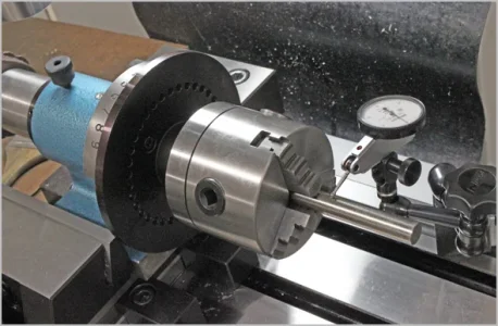

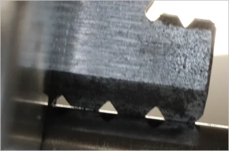

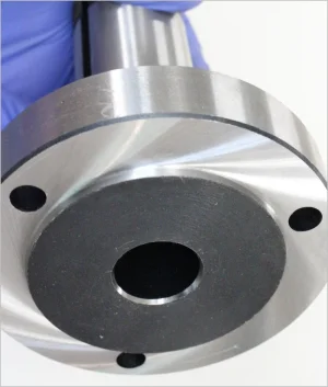

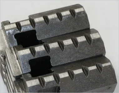

There are lots of these on AliExpress under different names. Seems like mostly used for small hobby lathes. Of course, how good are they? I noticed Accusize offered one that came with optional bolt on 5C backplate fixture so kind of best of both worlds. Available on Amazon Prime so I pulled the pin. It has a plastic insert part rather than metal but other than that looked about the same as others. I set the 5C adapter up (only) in my Spin Indexer I also my 5C lathe chuck. The lip was just over 0.001" TIR. So far so good. Mounted the chuck to adapter & my test bar. Not good at all, like 0.017" TIR. I spent some time examining, re-assembling, trying diffeernt jaw numbers, different diameter test bars. But it was pretty obvious the jaw grind was off.
I considered doing the jaw regrind ritual but I have yet to do one myself. Its not exactly easy at this small-ish aperture tiny opening. The wider diameter jaw set looked a bit better but was still about 0.005". They were laterally not very tight in the slides so I decided just return them. That part went smooth. It was done through Amazon return process, I wrote a short problem description, offered pictures but they didn't seem to want them. So back it went but I still dint have a chuck & now a bit more gun shy than I was before.

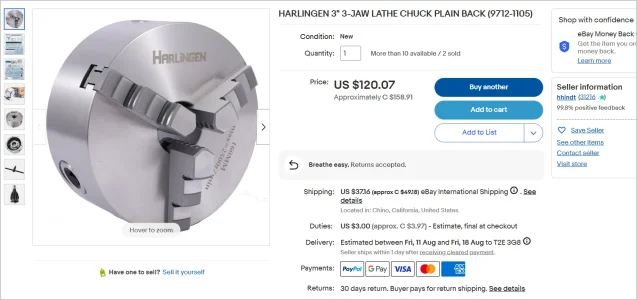

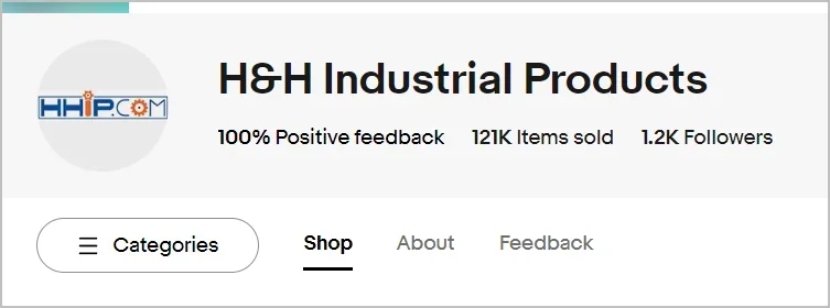

After some hunting around I saw these Harlingen chucks on Ebay by hhindt store. Its also at LMS & a few other distributers. Same bolt pattern, similar 5C adapter available. The specs read about the same or maybe a bit better, I can't recall its all crap shoot anyways obviously. But I got the sense maybe a small notch up so gave it a try.
Same runout on the adapter only but much better on the chuck with test bar, in the 0.001 - 0.002" range over all my test bars. About as good as I could hope for.

I noticed the chuck had some sticky areas when scrolling in or out. I hoped it would be just the usual deburring but you just never know.

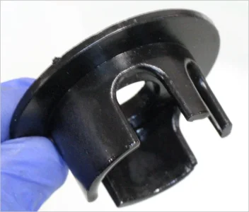

This chuck has a metal rear cover plate insert vs the Accusize was plastic. From what I assumed it just keeps the dirt out. It straddles the pinion gears but doesn't t really fit anything else internally. The cheesy screws were very loose as delivered as were the pinion retention set screws so I tightened them up. That made the scrolling action much worse, close to being locked up. So I took everything apart.

The pinions & scroll didn't look horrible for offshore. I blued & coudn't see any immediate friction. Every edge is raw machined usually with frags hanging off so de-burred everything. Re-assembled, still no joy.

Then I realized by pressing on the cover plate I could actually replicate the friction. I blued the end & scroll gear alternately & sure enough, contact. So tight bolts is pressing it against the gear. I thought about machining the end off but wasn't quite sure how much or maybe my tapping attempt had moved it. So I hand made a 0.015" brass shim. Got lucky Its exactly the offset required. After some more deburring , smooth as silk now.

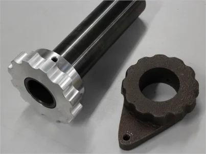

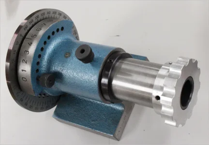

I made a replacement aluminum knob from scrap cutoff to replace the original heavy cast iron one with MIA handle. I don't think I would actually rotate while milling like a rotary table just trusting the collar to maintain axial position. I just use it to index to positions then lock it down for drilling/milling. Knob worked out OK but I think I made the circular recesses a bit too deep aesthetically. Looks like it should drive a cog belt or something.
