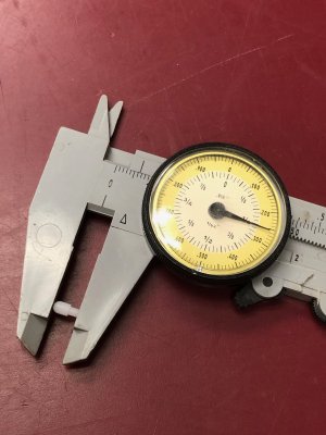

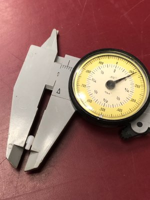

When I was in Toronto, a friend that I have there asked me if I knew anyone that could make some parts. These are ongoing parts used in a vaporizer on an anesthetic machine for veterinary use. I believe they are not in a critical function of the operation of the unit, for those concerned about liability. They just provide an indent for setting the concentration but does not affect the actual percentage of agent administered. They are an ongoing need as they get broken, so he is looking for someone to make them as needed. I would think 20 at a time or so but guessing. For now, I was looking for input. He had a machinist who made them but that fella retired (retired retired...he was retired but worked out of his shop afterwards, like many of us. Maybe he is even on here and I don't know)
I was thinking that plastic printing might be better than machining...? I think the plastic is a delrin. I am also thinking maybe brass would be better but need to check with my buddy. I did not get to have one in my hand so only have these photos but he could mail me one.
Could you print a bunch at once and then snap them off ? I don't have a 3D printer (but this might push me that way), or if someone here wants to take on the project, I can get more info. I have asked him for more info so can add to this thread later but thought I might get the topic going.

Hey Shawn I am assuming there is a hole in the middle, it would be easy enough to print off some maybe with PLA(material) that could be tried depending on the tolerances for fit and because they are so small one could use a smaller diameter nozzle .1 and get a more accurate replication than the .4 standard nozzle. I could print some off for you to try if you want.
It might not be too bad to turn down some plastic too if you can get an accurate center hole on such a small piece.
I have something similar in the past (about 25yrs ago) in brass, plastic should be no problem. Made a custom lathe cutter (screw machine approach) and did it one pass. With a collet chuck it would be even easier.

No hole in the center. Solid.
Depending on tolerances, I am wondering if just 1/8" stock can be used. I will check with him. Waiting to hear back from other questions.
Exactly how I did it, mind you back then with a 3 jaw chuck
Sounds good. When he first told me "about 3 mm", I was thinking pretty small for me but after seeing the photo and posting the information here, it does not look too bad to do at all. I am still waiting on quantities he would consume.
If he does need plastic and quantities are large, I may see if a member here wants to print them. I still think printing a sheet of them (picturing a flat sheet with pins sticking up) would be the way to go. But if quantities are low, I may just gear up to do them.

I do not know the make of this particular one but I don't think it is a TEC3 or 5, nor a Drager vapourizer. Those are probably the ones you are most familiar with, although with a collection as you have, maybe others. Those ones, and the Ohmeda's are the ones I came across most often. (ie, ever) My friend might own the company that you sent them to. I don't think there are many companies in Canada that actually service vaps anymore. And I think some take them in, then send them my buddy's way anyways. He has some pretty sophisticated equipment to calibrate them. (Yes I am deliberately not mentioning his name)
I was a biomed in a hospital in a previous career, then, for years, provided biomed services for local vets and clinics, including anesthethic machines, in my side gig till I retired from it about 6 years ago. This part is apparently a recurring service item. The more I type and get input, the more thought I put into this. I think it is plastic so that if one was to try to force the dial without releasing the lock, then the plastic will break instead of damaging the housing. As you know, vaps are expensive!!!!!! So better a little plastic pin break than scoring the dial bearing surface. Therefore, brass would not be a good idea either. As I mentioned, not a critical item.
I can make them, but was wondering if they are better done in bulk by someone. From what @Degen says above, it might be better to cut than to print. I assumed the other way around so thought someone here might like a little gig printing bulk paks of these. But, I am still waiting for more info. It sounds like I might be making them....:rolleyes: I am sure the first 20 will be a novelty, then it might get old. At least I should not get into trouble parting off a 1/4" piece of plastic!

This is an ideal part for someone with a screw machine. What you are manually doing on the lathe is a screw machine operation hence a little more tedious.
