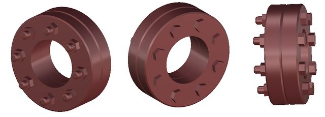

The fittings painted would work for running on compressed air, nuts and bolts would have to be made for the scale appearance. I was pretty happy with the 4-40 nuts and bolts I made using 3/16 hex stock and they weren't that difficult, just a bit tedious.

For the flanges, you could cast both sides as one, complete with fasteners, and a through hole for the pipe. Then just slip it on wherever you need and solder in place. Nobody would know it's one continuous pipe. Or use them to hide the joint between bends etc and solder the whole works together as a unit.
Since they'd all be the same you could easily build up a large inventory of them in the sizes you need.
While modeling that up I got thinking that maybe you could even selectively plate the fasteners too?
Mcgyver
thanks Dan, 100%...thats what I was getting when I said do them as assemblies and SS the tube in. We'll see....depends how well I can get the resin burnout working. That level of detail is entirely possible with wax investment casting, just that so far the resin has fallen short of what I can do with wax.

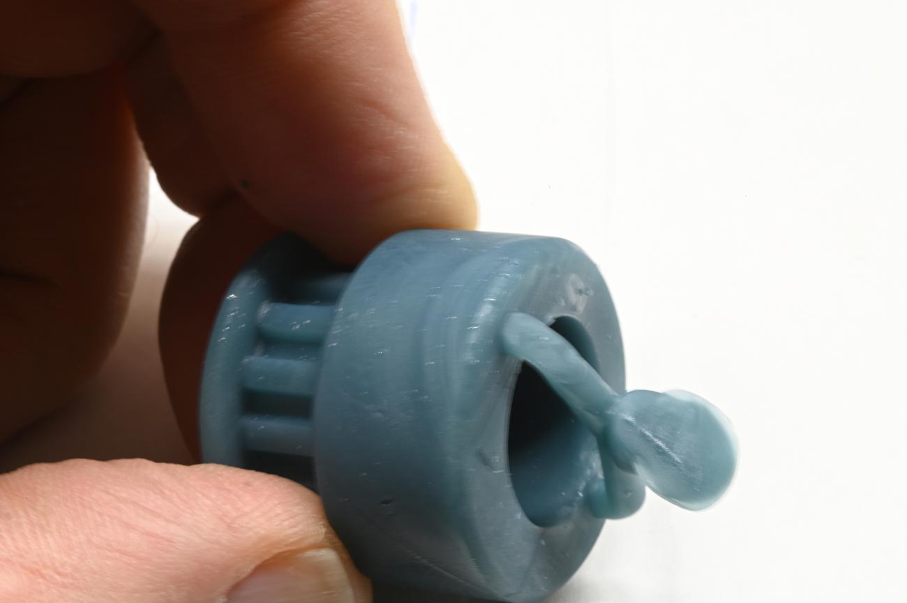

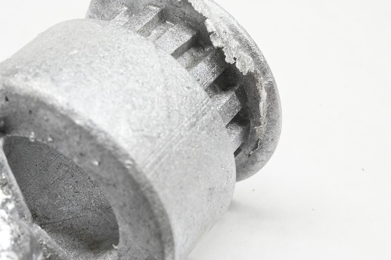

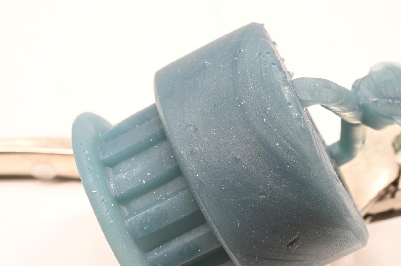

Thanks for all the encouragement! Here's a resin print casting, after lots of fails and resin changes, I had some better results yesterday with AL.
I switched to a much more expensive resin. Suppose to print and burn out well. The print wasn't very good (some distortion) but I think issue is too much adhesion to the FEP. Its a much clunkier part than jeweller would make so using it for mechanical stuff might be a bit out of its comfort zone. I'm going to try some different FEPs, see if the premium ones are better. A bit of PTFE also can help.
I have a bronze casting in a few hours, my second, after an overnight burn out. Bronze is a bit scary, 900F mold, 2000F metal....maybe I'm being a chicken, but keep in mind I'm doing this in my furnace room.

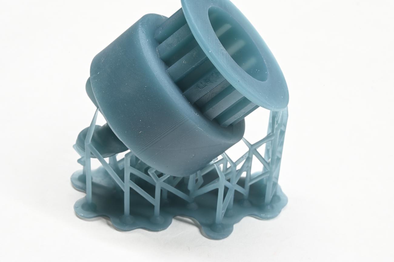

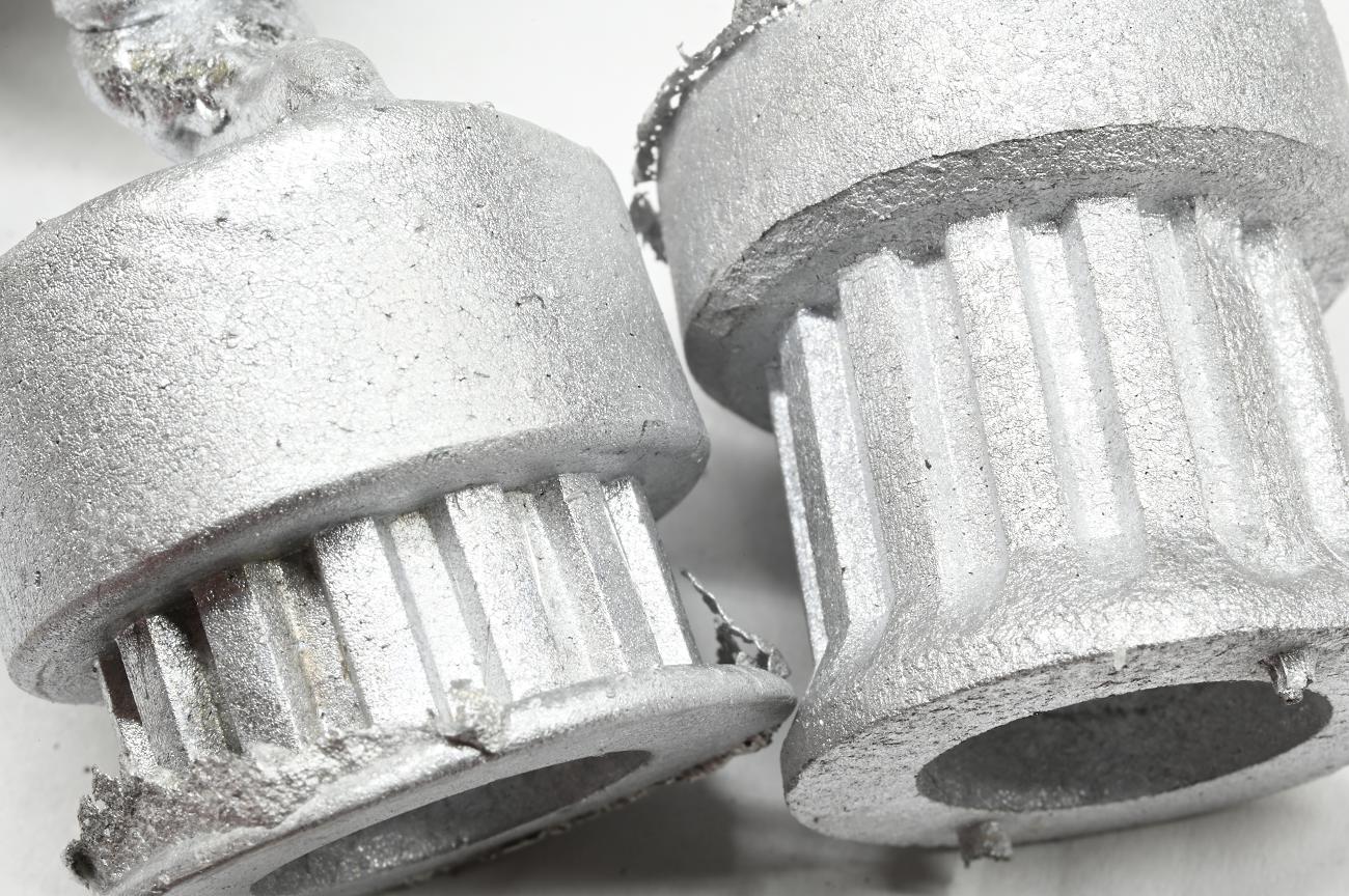

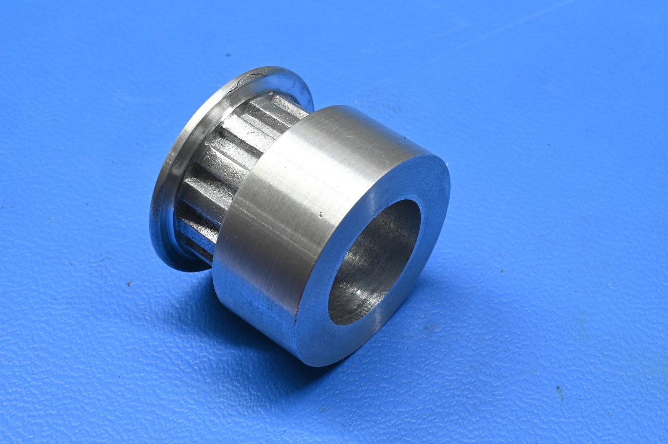

The early pulley had the teeth with a 45 degree angle to accommodate printing difficulties; I could only print it straight up a down. But the new stuff, Bluecast, worked ok with the usual angled/support print so I discarded the angled teeth on the one end.
as it is printed, after curing. The part is 1.050" OD, 5/8 bore. without investment casting (or some lost pattern process) it would close to impossible as there is no possible parting plane that I can see.
some distortion, likely too much adhesion to the FEP (film a bottom of resin tank). It shouldn't matter much as I will turn it away, but it's still something I need to address in my process.

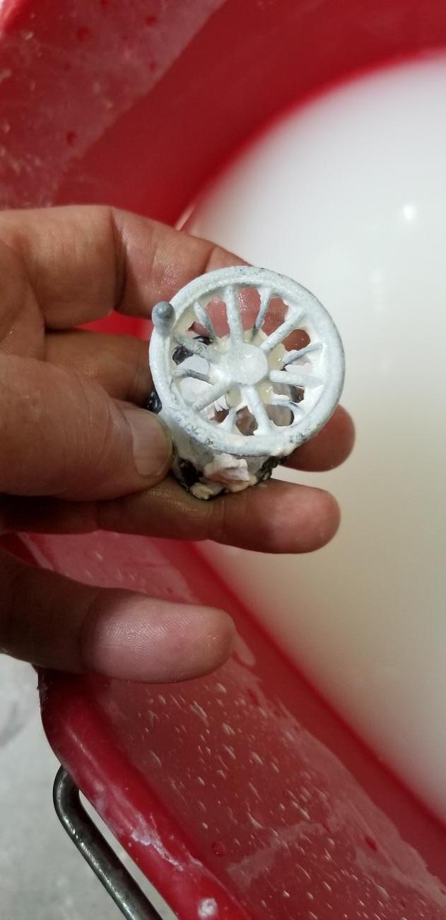

There was some flash, indicating a crack in the investment. Annoying, I'm using new Ransom and Randolf Plasticast, supposed to be the right stuff. However it was just flash....the burn out was good, no ash that I could see
early attempt....this one (left) has a much better finish

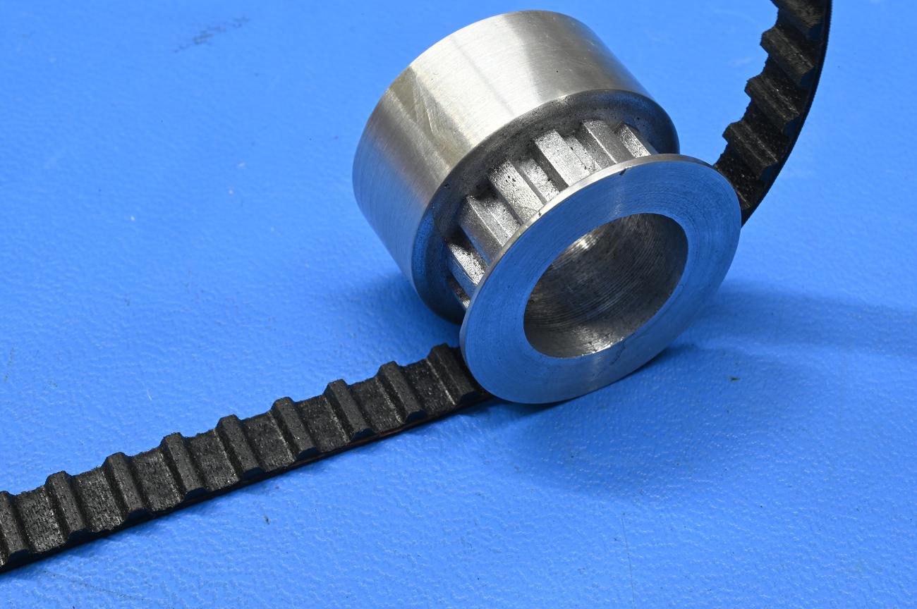

I reamed it then held on an expanding mandrel (I made a set foreverago) so I could clean up the outside. Concentricity is based on the cast bore being fairly concentric to the teeth, and a reamer shank is flexible enough so that it will follow the existing hole. After that the mandrels are quite concentric.
I would have just bought one but because of the bore to pulley size, I needed a larger diameter collar for set screws than any of commercial ones this size had. Yeah, I could of reworked that, but casting seemed a good option/learning opportunity.
Its been months (started in May!) of trying and learning...an arduous process! Still far from perfect, but finally getting usable parts. There are simply so many variables, the whole 3D printer world is new and immature in a lot of ways and while lots of resin printed jewellery is being done via lost resin patterns, I doubt very many are doing mechanical shapes (who cares if a ring distorts slight, might not even be noticeable) with thick cross sections....and in AL and Bronze. You are kind of on your own sorting the dozens of variables needing to be all just so.

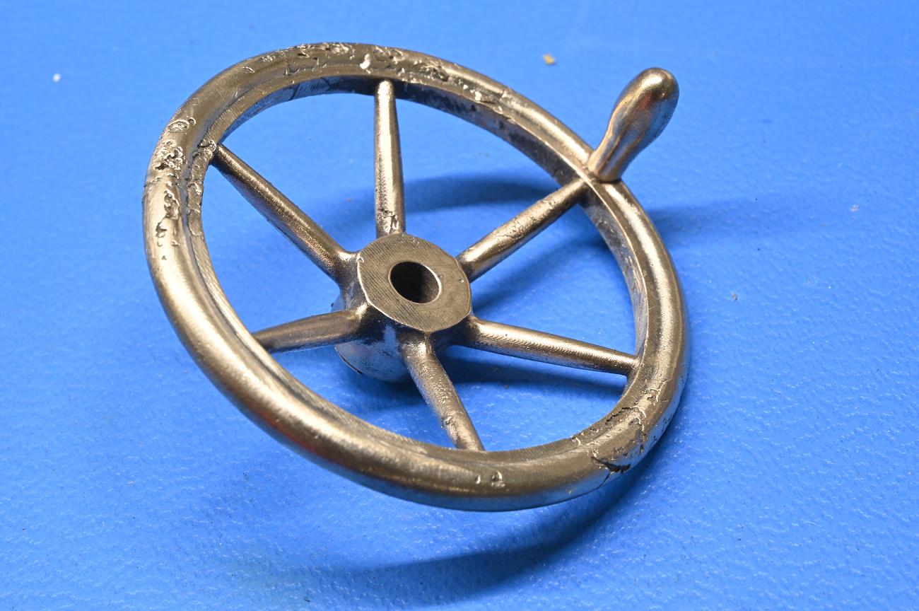

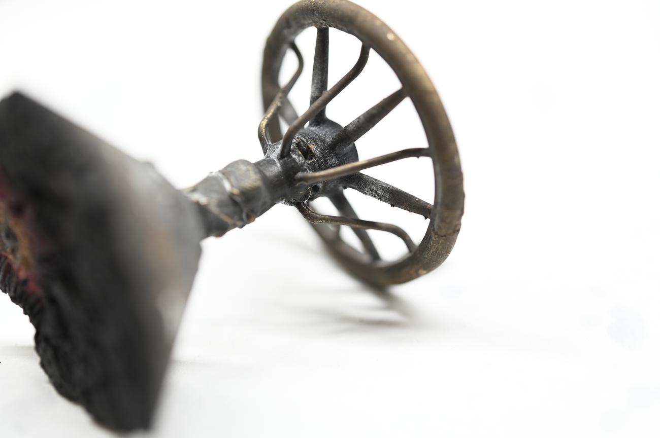

The bronze casting was better than the first one, but still has major issues.

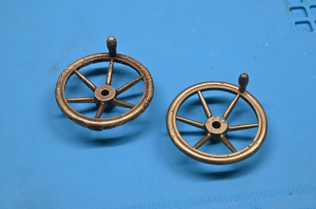

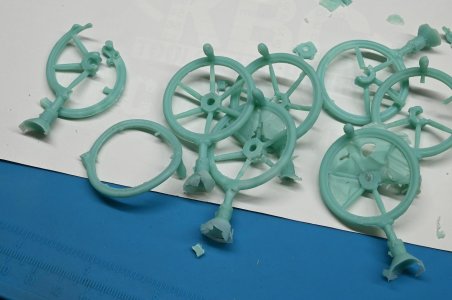

The pattern. Its a reversing hand wheel for a triple expansion marine engine, and is about 1" dia. Its six spoked, the extra curvy paths are runners intending to get better flow
Is it going to be a dream....or a dud
It looks good from a distance if you squint abit
but after a bit in a magnetic polisher the flaws are revealed

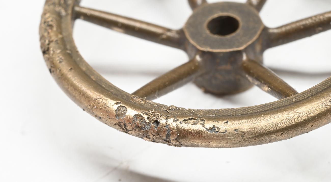

The shot below tells the story ....shows the issues clearly but also the potential. Notice how the striations from the 3D print clearly came through toward the bottom right. That's the incredible detail possible with investment casting. The outer ring is small, only about 1/8" cross section yet picked up those tiny lines perfectly.
My current thought, that this photo suggests, is its casting issue vs a resin/burnout issue (with some resins this is the issue....their expansion damages the investment). I'm thinking sprue/runner/flow issue. I was reading a bunch last night....lots going that can mess you up and it can be hard to get good information. Stuff like tapered runners to reduce turbulence, tactics to avoid "investment erosion" etc. It's all about getting the metal through the mold while it is still hot enough without damaging the mold. Time for fluid dynamics 101 lol
I used small runners connecting to the inside edge for ease of clean up. I think I will increase their size and maybe the frequency. I really don't want to put runners to the outside as the compound curve will be much harder to clean up, but there would be room for a larger dia runner so it would deliver better flow. Maybe. First I think I'll double the runner dia and fan it out at the inside of the rim...fanning out creates a bit of turbulence, but will deliver more metal quickly

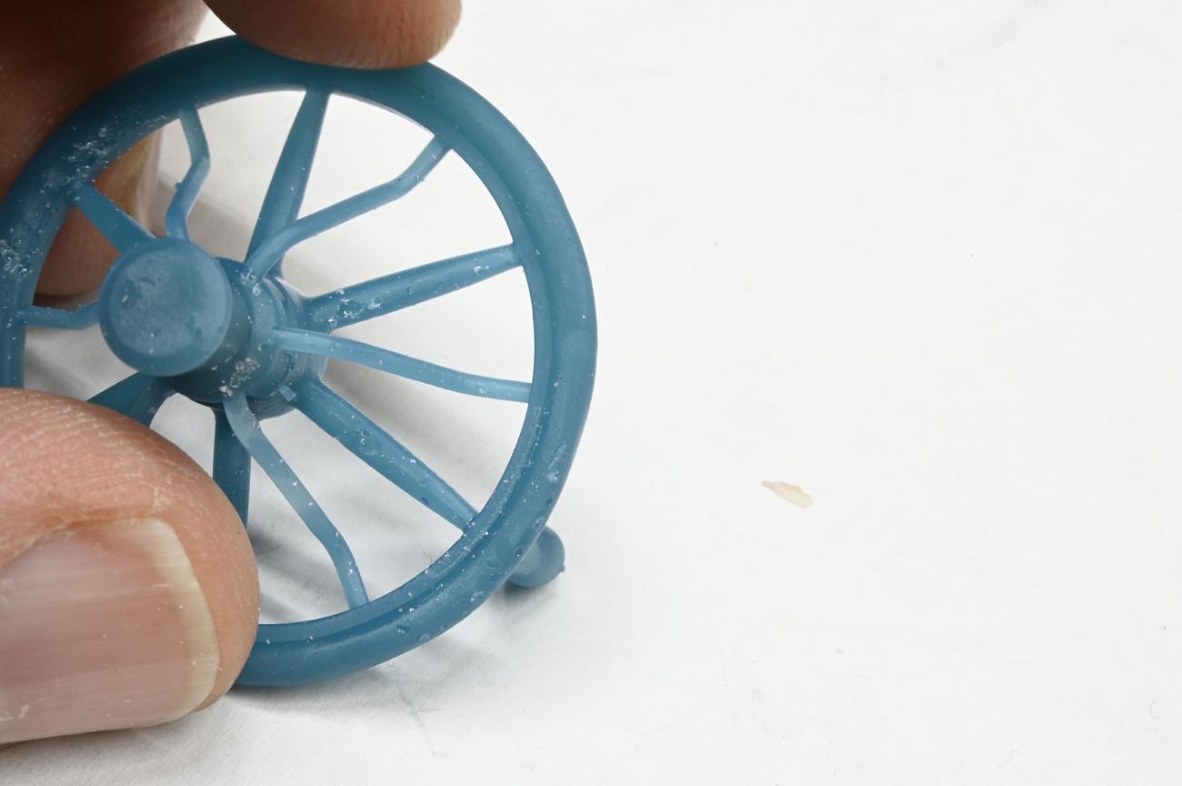

Is it my eyes deceiving me, or are a few of those surface irregularities in the resin model as well? Looks like there is some bubbling on the outer rim that got carried over to the finished casting. Not all of it of course, but maybe some contribution to the defects? I'm also wondering about pouring temp being too low, and prematurely freezing up when different fronts of metal are meeting maybe causing those defects too? Could be grasping at straws there, but it might be another variable to look at. Everything else was good, except the rings where all those different flows of metal meet is the reason for that thought. Turbulence is another one too, but with the casting under vacuum I'd think that would settle down before the metal freezes up?
As you said, there are many variables to work out. It's too bad there is such a long turnaround time per investment to try and work out the bugs. That's a good start though, I can't wait for the next installment.
Mcgyver
There is some distortion in the print, same issue as with the pulley I think. Based on other resins, I expected some issues with the pulley, but not with the handwheel. I expect that will go away with treating the FEP.
The supports on the resin are brittle and often/usually leave small divots as they break off, despite being careful. You are seeing that in the print, but don't much care as its the back of the wheel.
The big issue obviously is the very bad surface porosity on the visible side of the wheel. The part is relatively symmetrical, yet there is that porosity right beside and perfect area. Hard to key in on the source of the trouble
My first bronze casting I did 1915F and this one was at 1880F. The first was far worse (but of course I'm not isolating variables, it was a different resin). Both are the upper end of what to pour bronze at. In both cases the molds were at 970F. My learning continues as there is a lot going on - its not just about hotter. Investment breaks down at 1500F so poorly done spruing adds turbulence and can increase investment erosion.
I also don't know the material. I should buy some silicon bronze grains, but have already shelled out so much on the this journey, my credit card is worn out! The first material was a feedscrew nut and clearly had lots of zinc; at 1915 it was boiling and giving off the telltale with stream of smoke (I have vent overtop of the melter so no bit deal). The second was I think a tin bronze (a gear). Anyway, for sure mystery metal adds to the troubles, but I'm doubting its not hot enough. (one thing I have done well is kep a written notebook of the settings for each print, burnout and cast....far more organized than I usually am)
The cycle is long. 13 hours for a print. About 18 for a cast. The 18 means about one or two a week max....limited number of days when an be there at both ends of the 18.

Time for an update. It takes such a large block of time (close to 20 hours straight) to do a casting that I can usually only one attempt in in a weekend. Something goes wrong, and wait until next week.
I also bought some silicone bronze ingots, trying to eliminate possibles sources of the issue, i.e. using mystery metal.

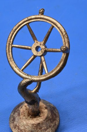

Still lots of flaws
MWZ_5514-1300x864.JPG \
The one at the right, is the above cleaned up an few hours in the polisher. Better, but far too many flaws for this dog to drop the bone! :)
This has been brutally frustrating. I've a spent a small fortune on different castable resins and so far all are s**t. I think the issue is whatever the resin does on burnout is damaging the mold, but to be sure, i.e. isolate that, I decided to do a casting with a wax pattern instead of a resin pattern.

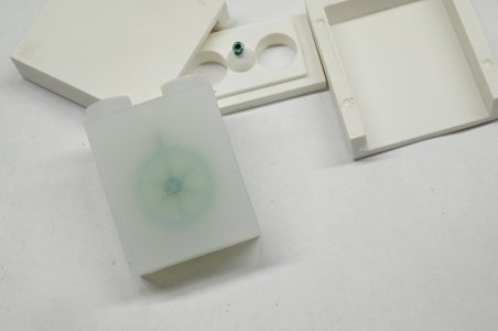

I fortunately have a vulcanizer and wax injector (when I bought the oven and vacuum caster it was a complete kit from a guy leaving the business) so it shouldn't be too big a deal, right?

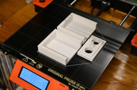

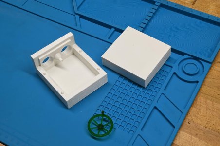

The first thing is to make a mold to create the wax pattern, using the 3D resin printed part. As the part is somewhat fragile I elected to make the mold with RTV Silicone (that btw stands for room temp vulcanizing, no heat vulcanizing needed). That means pouring a liquid from using a press vulcanizer, far easier on the pattern.
First though, I need a casting box for the the silicone. 3D printer to the rescue
It did take me two tries, the first had too many air bubbles. The manufacture claims no vacuuming is necessary, but I found this highly optimistic. You might be able to dissipate them by vibration, hold something against the box, but have a vacuum made that easy

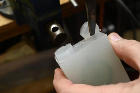

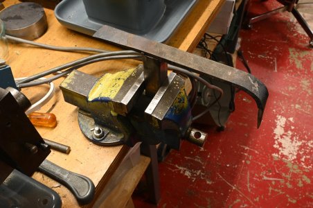

There are some tricks to cutting the mold in two. You need a set up like shown below, so you can pull the rubber apart to keep cutting inward. You also put in some curves so there is lots to register on.
This is just cutting a bit of excess material off, but shows the idea of its use

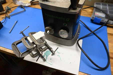

Ready to try. The wax is at 180-190F and under about 5psi of pressure (hand pump, black knob on the top right of the injector)
Injecting with the rubber in the 3D printed box shown below proved to be incorrect. Best to clamp between two steel plates - lets the vents work.

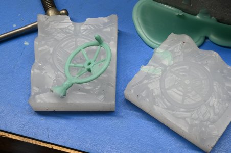

and try, and try and try
Everyone had some error on it. Incomplete, hollow sections, etc.
What went wrong? First issue I had was air entrapment. I learned how to cut vents in a mold.
The thing that kept nagging was how soft the mold was. It seems like I couldn't take advantage of the wax pressure without having to squeeze the mold together so tightly that it was badly distorted. Commercial RTV sold by jewellry supply places is listed at shore 36. The The RTV Silicone I bought, claimed on the amazon site it was Shore 30 (A scale). I figured it would work. This stuff is not cheap and clearly says its 30A https://www.amazon.ca/gp/product/B09CYYB311/ref=ppx_yo_dt_b_search_asin_title?ie=UTF8&psc=1
I did have a few jewellers molds which seemed far stiffer than my RTV mold. But I says to meself, maybe the rubber is old and stiff?
