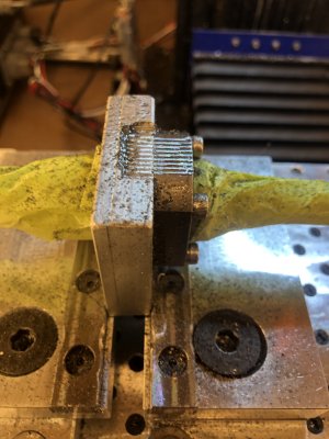

What diameter and lead are your ballscrews?
Not a lot of space under there, so I’m going small (1605). To get it to fit I’m going to need to grind / mill the flange. I had an old 1605 shell and for a reality check, I ground down the flange and it now drops in. Will do the same for the new one when it arrives.
I can live with a little bit of error on the Z axis so I used 1um Ditron magnetic scales and they seem decent, but I want to avoid the cyclic error for the X axis, so I decided to use a higher accuracy glass scale for the cross slide. Both Sino and Akron offer pretty small glass scales that have shown to be quite accurate. I’m still waiting for that scale to arrive.
I had to do the same thing on both sides of the nut when I installed the 1210 in my Milo mill.
