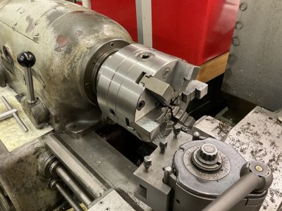

6 jaw chuck options?
Have you looked at pot or step chucks? You can get them in 5C to some large sizes...
Oh yeah, that's not a bad idea for shorter pieces, didn't really think of that before. I should keep an eye out for 5c emergency collets now that I have this sjogren thingy.
@mjautek - if I needed to hold thin wall like you describe, I would make a home-made collet that is tightened by my 3 or 4 jaw that would subsequently close up to hold smaller parts like you describe. I'd prolly make them each a custom fit for whatever part I needed to hold. Even a very high quality 6 jaw could never equal a collet for work like that.
I guess the whole appeal of the 6 jaw or whatever is to save time and not have to make custom fixturing. sometimes I get frustrated because it feels like I spend all my time here working on the shop (including making tooling) vs actually making parts... that said I have made a collet before come to think of it (as a disassembly tool though):

What sort of concentricity does this work require? Unless its a collet, the surface you chuck will likely be out several thou no matter what quality chuck you get. That's just the way things are with a scroll chuck.

I have a Myford S7LB with the original PB 100 mm chuck. And was about to splash the cash on a six jaw 100 mm chuck. One of the chaps at the engineering supply firm that I went to, took me aside and said £20 will buy you a set of soft jaws for your chuck.
He also explained that rather than continually machine them and have to buy another set of soft jaws, to carefully drill and thread them and then make sacrificial top soft jaws. This is exactly what I did. This chap saved me spending nearly £400 pounds on a six jaw chuck.

I certainly agree that soft jaws are great, and that two piece jaws are a handy feature (I use them on a couple of the 3 jaws chucks and also one one of the 4J independents and a 4J scroll). Your arrangement looks great, it does stick out a bit, but as a modification when you have solid jaws - you do what you have to.
I still see the 6J as a different style of work holding compared to a 3J. The 6J is great, and has it’s place (I use it for thin wall pieces, gripping delicate surfaces, such as on threads) and there are certainly work arounds but they are very cool and a great excuse to spend some cash.
