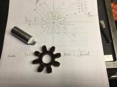

This is the "CJ" style urethane spider from the love-joy type coupling between the spindle and its drive motor. I have already glued the broken off ears back on (you can just see the one @ about 10'o-clock position). The spider is an odd-ball size, of course, and not available off the shelf.... Hence the drawing and the home made cutter.
Here is the cutter in use:
I made Delrin spiders first to see if my geometry was correct before I attempted it in rubber...
If rubber does not last, I now have an accurate part that I can make a mold from and cast a spider out of liquid urethane, if required.

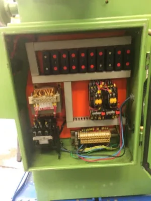

All components of the grinder work, just not at the same time: I am waiting for my shop RPC so the machine can be powered properly with 3 phase, 220 V.
Here is a pic of the "brain" of the grinder:
There are a bunch of limit switches and electrically/mechanically controlled hydraulic valves that complement this panel. That is/was my primary reason for not running the machine with just 3 appropriately sized VFDs (one for each motor) and re-wiring the whole kit and caboodle.

A) Cutter
Please refer to the hand drawing below:
I created this using the broken urethane spider and the two metal mating couplings. You can see that the "teeth" are basically sectors of circles whose centres are located on the perimeter of other concentric circles. Specifically, item 4 with a diameter of 28 mm will give the correct side profile of the cutter to be made. I have a Dumore Tool Post Grinder with lots of grinding wheels of various sizes. I dressed on of these to a diameter of 28 mm. Also from the drawing you can see that the maximum linear distance between two adjacent teeth at their apex is 0.716 in. So I decided to use a piece of on hand 3/4" drill rod. I first milled a flat on the end to exactly 1/2 the diameter =>3/8" by clamping the round piece horizontally in the vice. I then set up the tool post grinder on the mill table and mounted the drill rod in a 3/4" collet in the mill spindle. I had it turning slowly and fed in the grinding wheel from the side to start shaping the sides on the split blank. See pic below (the camera did not like the LED ring lighting on the mill quill - hence the blue tint).
The relieve required to make it cut is automatically obtained by it rotating while being formed. The principle behind this is similar to an engraving cutter whose point is also first spilt and then the side profile shaped. I believe Stefan Gotteswinter has a video on sharpening/making cutters of this type.
I honed the cutting edges and did not bother to harden it since I was only going to cut Delrin and, later, Rubber.
