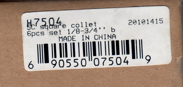

I got mine through AliExpress. Have only used two of the square ones and one hex. Here's the label from the box of square ones which came in individual round red plastic 5C collet boxes. I tried the fit of the 3/8" one just now on a piece of square CRS that had rusted badly on the end so first I had to sand off the rust. It slides in an out of the collet nicely. But with the calipers the piece also measures 0.372"
Mine did not mark up my material.
