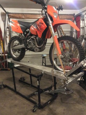

On a funny side note, the wedding anniversary is today, here is the wife's gift to me :D
