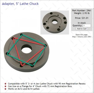

I'm looking for suggestions for a 4 jaw (independent) chuck for my 10"x18" Craftex B2227L lathe.
Size suggestions and possible suppliers. Don't need a Kurt chuck (you know what I mean) but would like it to go around a central axis reasonably well.
Thanks!

Backplate is needed. Typical Chinese import style. Can't find the specs in the manual. (of course)

Its a 3 bolt from the back and most chucks are 4 holes thus the need for the backplate.
Even the ones you get from BB need a backplate.
Yep. That's what I have.
Does the 5" 4 jaw chuck from BB include the backing plate? Or is it a piece you have to order separately? That's what I think you are saying Mr. Herbage. ;o)
No its separate I believe bb sells them as well, my plan is to make my own there is also people selling backing plates on ebay and ali express. The point was that not very many 3 bolt options out there that I could find.

Boy..... that's a very deceiving description on BB's part. And looking at the LMS chuck specs the 4J's are 4 bolt. As I recollect the 4J I got for my my 7X12 was setup for 3 or 4 bolts or maybe that was the spindle mount plate I'm thinking of?
As far as I can tell, this is the adapter for the lathe indicated by the model of the chuck.
https://www.busybeetools.com/products/face-plate-for-cx708.html
Perhaps it comes with the adapter for the older lathe. Because of the confusion, I would really suggest giving your local Busy Bee a call and asking. I have usually found them to be very helpful. I just wish I had one closer.
