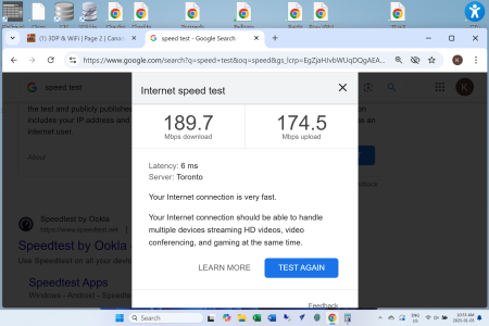

The solution for my shop is possibly relevant to your situation:
My shop is beside the house but in a steel frame building that is impervious to external WiFi signals. I buried a conduit between house and shop to hold a CAT6 ethernet cable. The shop has a Ubiquiti access point (https://www.amazon.ca/gp/product/B01E9MYG9K/) to provide local WiFi. A bit of a pain to install but decent speed and 100% reliable:

I'm likely going to trench in new conduit to the shop but at the moment I can get 45Mbps over my powerline extender so that's fast enought for my shop needs.
