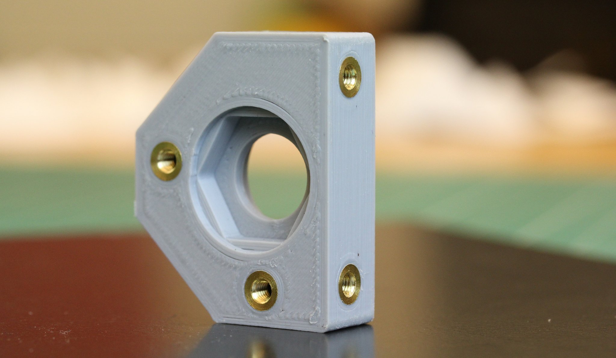

@djberta when you say thread inserts do you mean a particular style? I'm also familiar with the ones with aggressive external threads like for wood etc. but assume that would be too coarse for 3DP application even if heated?
Peter, there are press in ones for plastic, you press them in with a soldering iron. I've thought to make some sort of stand to ensure alignment (which can be a problem) but haven't bothered yet. You can also create tight fitting hex recesses in the mate an insert a nut .... I use that a lot and think its a bit stronger

PeterT, Mcgyver posted them. I have a couple little sets of the inserts and press them in with a soldering iron and they work great. I like to get the longest ones that I can but i'm super cheap and buy the cheapest I can find on amazon. I have seen that you can also use some of the ones made for wood working. I have also trapped nuts inside of prints. You make the print with the area for a nut to fit, then pause at height just above the nut cut out and put the nut in and resume print.

I decided to buy some heat-set to try. This kit comes with the solder iron mandrel. I have variety of irons.
Well that was painless. Used my 40W Weller with included tool. When I read ~185C I started feeding into 3DP. Went in slowly & predictably, maybe 3 secs? When it was ~ 0.5mm proud I flipped it over & pressed it on a flat surface to make it flush. Seems sufficiently strong for what I'm targeting it for right now. Maybe someone has done a gorilla test.
Nice job.
If you need more strength orient the design such that the insert would have to be pulled through the part.

Yes exactly. This was just testing the recommended (5.3mm) hole ID & (7mm) counterbore depth for M4 insert. I'm just showing the bolt for fun. Right now the insert is resting on the counterbore ledge & it ended up flush OK. But the real parts would have the 4mm bolt clearance from the underside so its pulling the insert into the CB ledge. Now there are situations where I may not be able to get the iron in so it would only be shear force against only the knurl. I'll figure out a tug test on this coupon,
