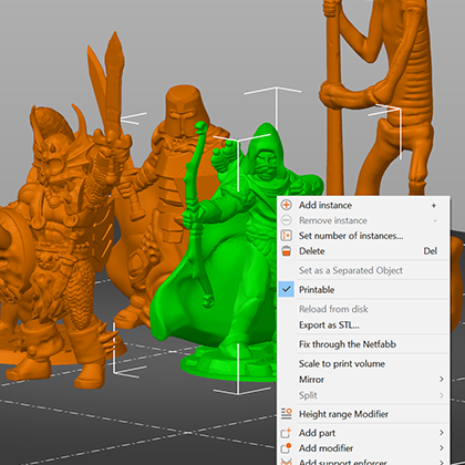

I've only used the one slicer Prusa Slicer other than looking at the bambu slicer a few times. I'm wondering if there are other slicers with better control over print parameters when you are printing multiple objects simultaneously. For example I want to print a drive coupler with 100% perimeters and full infill and at the same time print a motor mount which only needs 4 perimeters and maybe a 20% infill. To do that I have to print the first part in one session and the second part in another. Is there another slicer which provides this level of control?

Actually it looks like you can do this in Cura.
Cura is the slicer I use the most and I'm happy with it. Just learned it can separate a multi part print into individual objects as well with the proper extension.
It must be possible I would think, can it be treated the same as printing with a 2 headed printer? You would have control of the fills.
unless the pieces are drastically different heights (and that can be worked around with part placement) your much better off to print them one at a time, its faster, the layer adhesion is better and they turn out nicer
there is an option in cura to "print simultaneously" or "one at a time", the latter will print the second part in the same print event, just one after the other, im sure Prussia slicer has the same, im not sure how to make them have different print qualities, however i do believe there is a way
As phaxtris said, Cura can do it. I thought Prusa slicer could do it too, and much more? I've settled on Cura for the past couple years, but was curious about trying Prusaslicer as I thought it offered much better control over a lot of details like this.
Omg RTFB thanks @gerritv
Well at least we’re discussing it.
