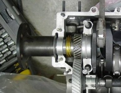

    they ran rope seals in quite a few engines in years past, even the original 2 piece rear main on a small block chevy was a rope seal...
  • phaxtris
    Yes the slinger is the oil seal, the only thing i do not have is a left hand thread on the exterior of the prop hub, and i knew that...
