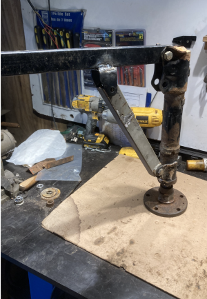

    Thanks Janger. I am in Ottawa, Regarding welding - I am grinding away rust and paint to the bare metal, It might be not seen on the...
  • G
    Gennady replied to the thread Shop Table top crane.
    I am still looking , I should have another pipe that is fitting inside. so far it looks like that. Of course, I will clean everything...
    Good suggestion, thanks Ryan. I will consider telescopic boom. Just need to find rectangular pipe that fits in other pipe. Regarding...

    Gennady reacted to phaxtris's post in the thread Shop Table top crane with Like Like.
    Well I can see the convience, but I don't think it's a great idea. Best to keep the boom real short and the loads real light, the moment...
    I will be turning external 'tube' around shaft and shaft itself is screwed into base - it is more convenient this way, and the 'tube'...
    Indeed two pipes pivot is stronger, Just to note - I am using it fully collapsed, no plans and no means to extend it. Regarding...
    Well there isn't actually a bearing in there, it's just turning on the seals, when it's fully extended like that there is only an inch...
    why not ? any hidden problems ?
  • G
    LOL - it is vertical post. No internal pressure and up/down movement, only rotating :)
    I guess bottle jack is not in use anymore? Does winch enough to pick up load from the floor and bring it right to the mill table ?
