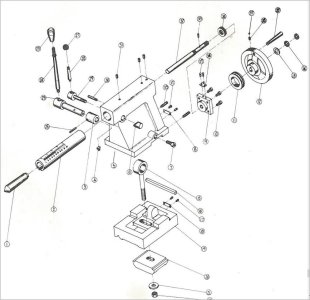

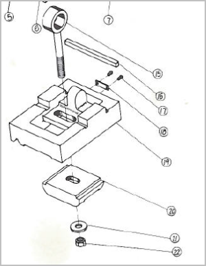

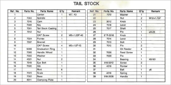

    PeterT replied to the thread Tailstock clamp.
    @Susquatch they look similar. My read: Lever 24 rotates Cam 3. That pulls threaded eye bolt 15 basically straight up, should not be any...

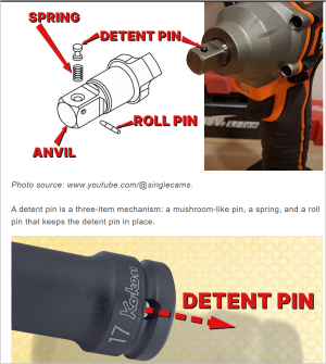

    PeterT replied to the thread Socket adapter question.
    I worded that poorly. The square profile is responsible for applying torque. Normally a sprung ball engages a matching detente to retain...

  • Susquatch
    Susquatch replied to the thread Socket adapter question.
    No. The pin is just a regular pin. It takes no impact. It free floats in the socket and square drive. It is only retained by the O-ring...

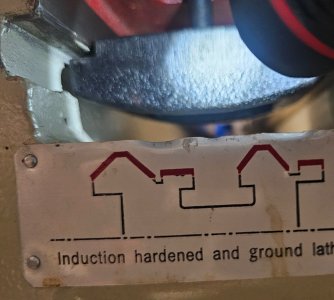

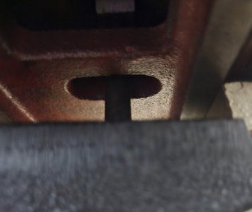

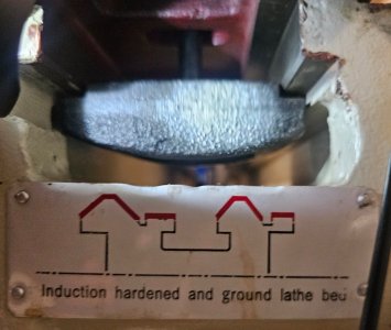

    Susquatch replied to the thread Tailstock clamp.
    Here are some photos of my block. As you can see, the glued on shims are gone. They are not even in the swarf pan. That fix was...

  • P
    You are saying the pin is an integral part of the locator on the square drive system & the rubber O-ring is to keep it retained...
