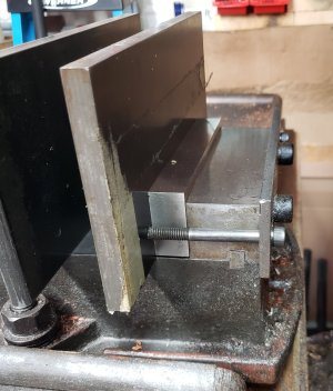

So, I have a chuck of 1/4" aluminum plate that I'm reusing for a project. I've made the long edges parallel by claming in the vise and end milling the edges. That's all well and good but what is a simple way to make a short edge square to the long edges? The stock is roughly 5" X 11" and my vise won't open wide enough to hold it. My vise is not one of those new fangled ones where you can move a jaw to the back edge.

I can't mill the short edge with it standing up in the vise because I don't have enough Z height. Even if I had enough height, I think the vibration would be pretty extreme. It is only 1/4 inch aluminum plate.
But, my jaw liners are about 0.400" thick each. If I remove both, I have _just_ enough capacity to hold the workpiece! Whodathunk! Thank you! I'll give that a go later.

As @Degen hinted, removing the jaw liners gave me just enough room to hold the workpiece in my vise. It also turned out that I was just inside another limit:
The vise has mounting brackets fore and aft as well as on the sides. Just as the front bracket hit the column, I was finished the width of the cut. Whew!

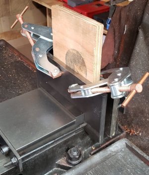

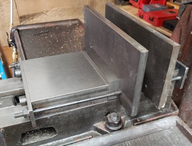

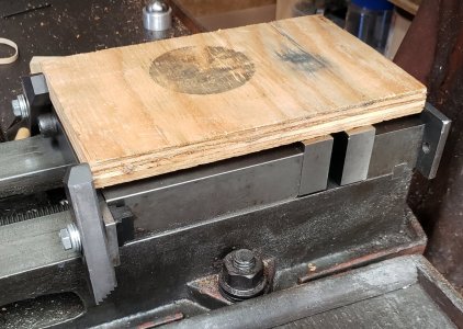

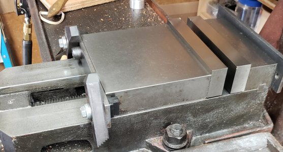

I’m Lurking at lunch time here. Another idea to increase vise capacity. Make a tall back jaw and make a second jaw out of L angle shaped material. Bolt the L to the top of the movable vise well back from the movable jaw. Ie Drill and tap into the movable vise body. Sort of a substitute for moving the jaws to the back of the vise. Is that a good idea? I’m not sure. It seems there is enough body there to put in some bolt holes. Has anyone done this?
I made up a couple of plates which get bolted onto the outside section of the vise jaws. Drilled a couple holes to accommodate the tall jaws (.5" x 10" x 5") for tall work. For wide work, the rear plate is higher than the vise jaws, and on the front I bolt on a couple of table clamps.

Make a simple vector diagram of the force loading on the vise.
If the moments are too great you may be prying your vise apart.
Remember the lever created by the large plates.
I love this! But damn you! Now I have yet another project!
And ya, @LenVW is right, gotta manage the leverage forces. But a vise is for holding things while you machine them. A little bending is ok as long as you know it's under the yield point and stuff isn't popping out of the Jaws or moving.
