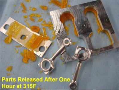

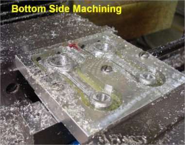

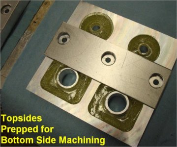

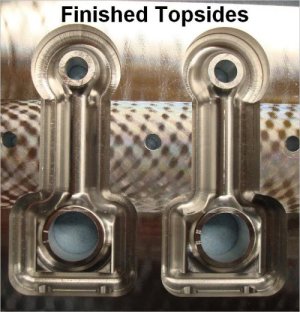

Anyways, I'm happy to use CA on smallish things stuck to a mandrel. As the parts get bigger or more valuable, I am reluctant to to risk fly-away. Another technique I see used is is bedding a part in epoxy (hardware 5 min is fine). It completely conforms to whatever odd shape. Then you can machine other features. Once done, just use a heat gun to soften & out it pops. Here you have much more lateral 3D support because the goop is 'potting' the part. It also requires much less heat to soften & distort to th epoint the part can be popped off.
Epoxy potting technique for 2 sided cnc milled parts.
Pics from HMEM, Terry.M quarter scale 'Offy' engine con rods.
