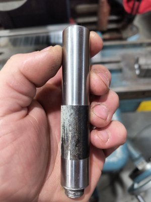

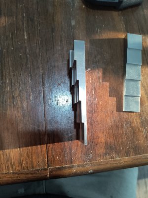

Few pictures of stuff I did with my surface grinder that I have on the phone
Edit.
O ye as for money hole it's no worse then milling machine depends what you want to do with it. Making parts flat is about as cheap as it gets. Wanting to make parts with complex angles and radiuses I think is still reasonable cost wise. But like any machine you can dive into real specific speciality stuff that all requires specialty accessories that can cost a shit ton of you want to keep .0001 tolerances making stuff round. Harig no1 punch grinder will drop your jaw to the floor if you want to buy one new. same as anything suburban tools sells new for surface grinders. Still can be bit pricey for that stuff even used but unless you need it now or plan to make money? with your machine. you can sometimes get that stuff used for cost of another surface grinder.

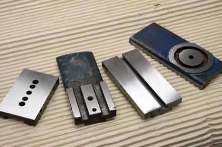

Some photos (just to be a good enabler 🙂 )
finish, flatless, squareness etc to a high standard on tooling
after scraping one side, the other is quickly ground

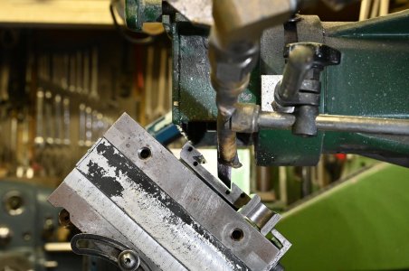

using the side of the wheel to grind a small angled surface on a dovetail - yes you can use the side of the wheel!
