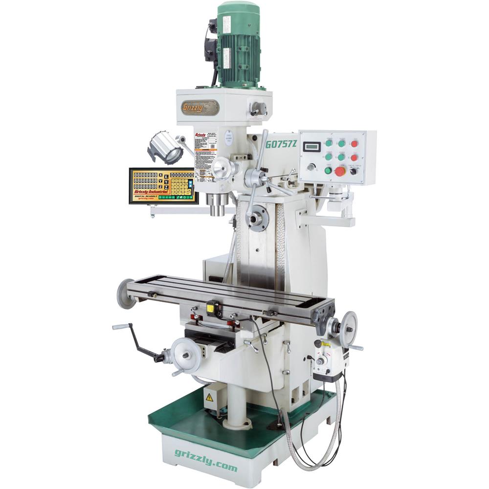

Would you like Horizontal milling features? If so this one is a good starting point but will require a lot of work to make into CNC and is still only R8.
