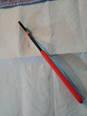

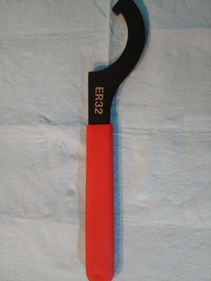

@Felis for what it's worth I use the ER32 collet wrench available from accusizetools.com page 29 of their catalog, item #0532-K032 at $12.00.
For my money they are a well made single tooth wrench, soft grip handle fits nicely in the hand,. Actually I have 2 of them one stationed at my hobby mill and one for my lathe.
210 mm long x 5 mm thick
open the catalog from here check it out www.accusizetools.com

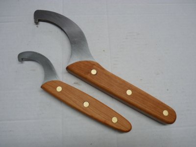

@Felis - I believe ER32 uses a 55mm wrench, if you want the one I have it's yours. The picture shows the fit on the ER40 nut so it should be good on the ER32.
I'm about ten minutes west of Sooke so it may be cheaper to buy one than pay the gas to get out here. Anyway, the offer is there, your call.
