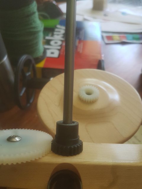

I resin printed one a while ago as a test, after a heated debate on the HSM forum about 3d printed gears actually being "gears". I didn't get any pics as I was too excited to go out and try it out. It worked great, BUT the resin I used was too brittle for the intended use (Elegoo black , just used what I had) and it broke after a couple heavy passes. I will admit I was pushing it to see how it would do, and have no doubt if I needed to cut a couple metric threads it would have been just fine, and I could have babied it through cutting many threads.
That's another "gear" I printed from the same resin for my wife's electric spinning wheel. It will last a lifetime in that use. For a change gear, I'd recommend a stronger resin than std elegoo black. Something printed in a tough filament might do, but the inaccuracies of FDM might become an issue, or they might not depending on your level of acceptability. Not sure what you filament printed yours in, or what infill, but the elephants foot might be a problem. Will probably have to face that off.
