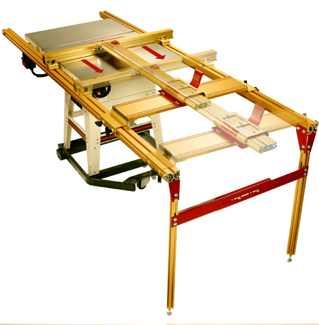

I must say that Incra Tools also has a one of a kind fence system for table saws and routers, but I'm positive their product is revolutionary...

The Incra fence is a beauty but holy moley it's a major space hog for wide rips. And insanely expensive in Canada. That said, Inca has amazing support and make beautiful products.

I will say that Incra has outstanding support and pre-sales support. Back in early 2021 Mark Mueller sent me a highly detailed response to an email answering all my questions about the various options for mounting to a custom workbench I am going to make. With brother's basement I can now make table with the Incra 52" rip system, with a 39.5" deep table top, and 32" LS positioner.

The beauty of LS positioning system it that it can be dismounted in seconds to leave a totally base work surface.
I was looking at the real estate between the rails on the Incra and there would be a better use than just open space.
My saw came with the long rails so I made use of the empty space with the router and can use the saw fence with the router (carefully).
