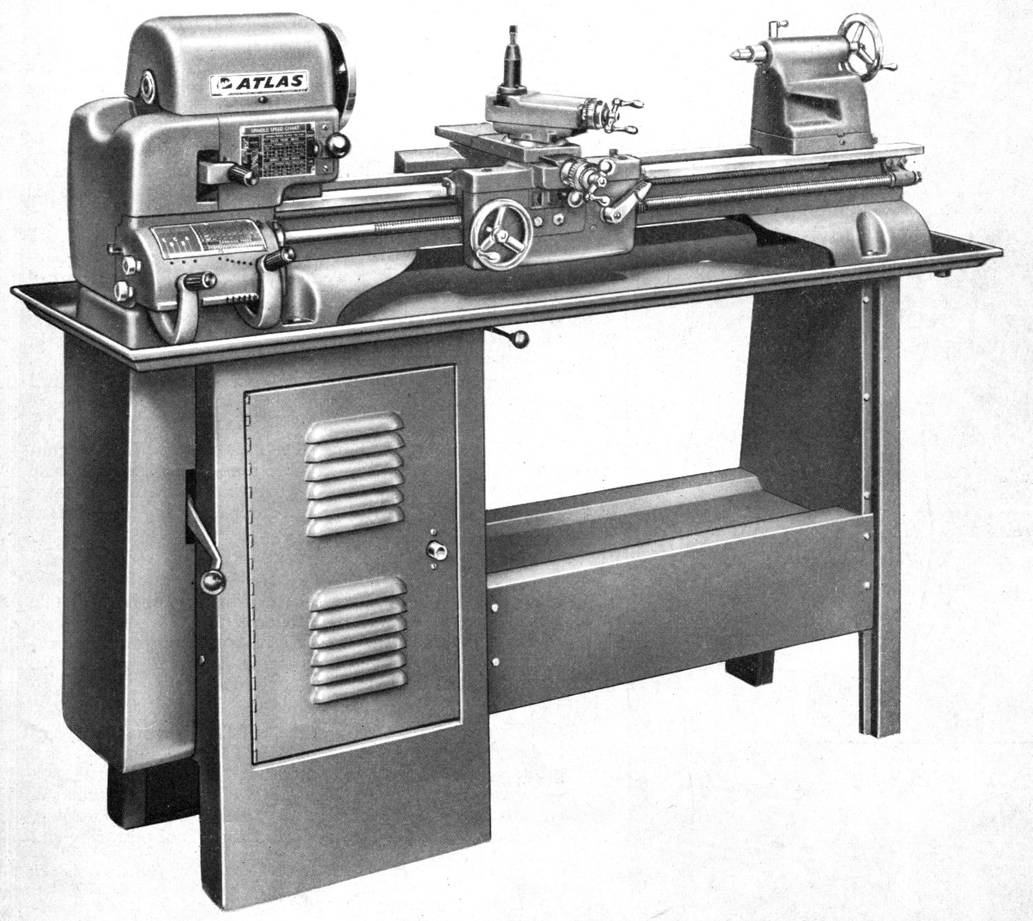

AIUI, the post-1957 12 inch models were much beefier than the earlier Atlas lathes. The 12 was also offered with bench-top or 'under-drive' configurations. Example of the underdrive:
More details:
