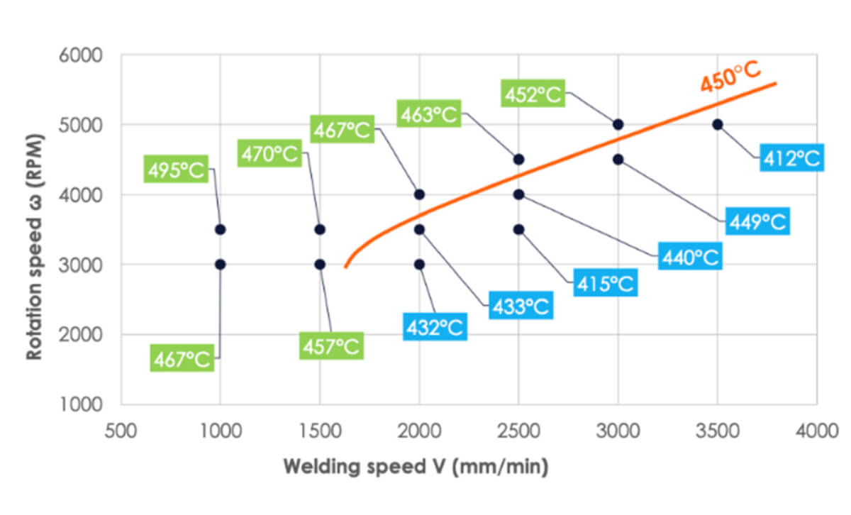

Degen - well I said "Quite cold". ;) You got me wondering just what is the temperature for friction stir. One example I found is 450º C. (850F). Not exactly cold but colder than electric arc welding at 4000º C. It is pretty strange the metal does not melt but softens and flows.
These people make a friction stir temperature sensing instrument and produced this graph: https://stirweld.com/en/temperature-measurement-fsw/
