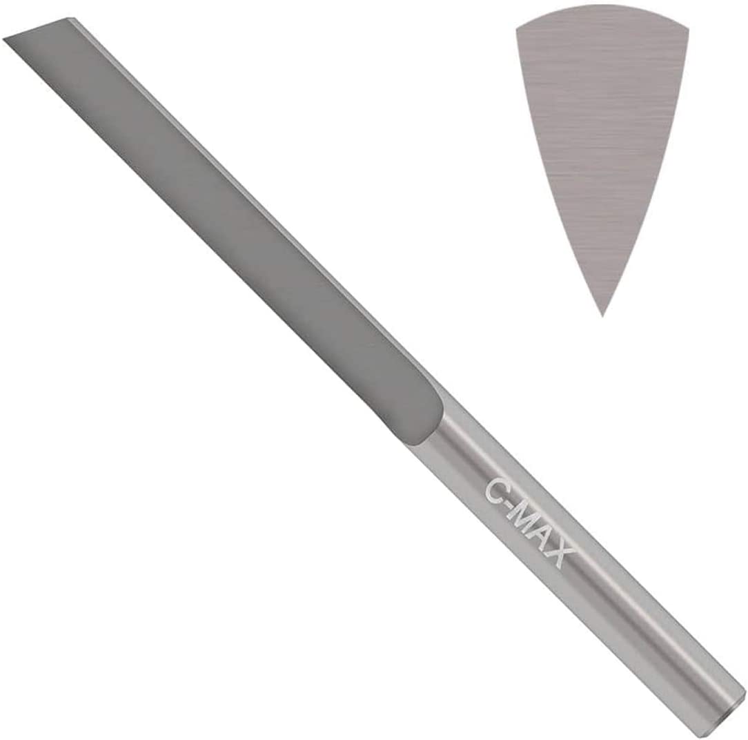

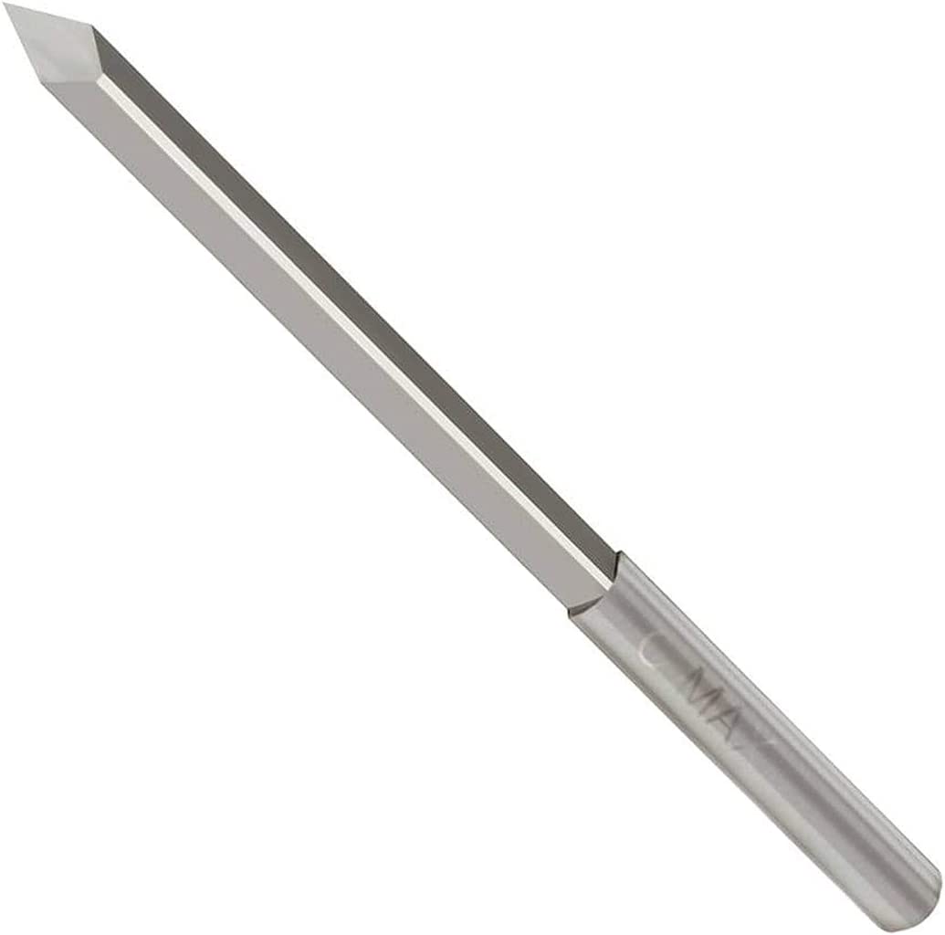

I'll be grinding carbide rods to make custom tooling... mostly for engraving. and regrinding existing profiles. And grind tunsgsten carbide rods for tig welding.
I planned to rough shape on silicone carbide wheels as we do now, we have a rough grinder and a finishing grinder. The plan is to make the finishing grinder with both diamond wheels to smooth finish the rough cut tools

not fluting, at least not until I get a tool and cutter grinder... a table top version not a massive monster.
I'm making small tools for engraving... and use in pneumatic engravers, and custom ground wood lathe turning tools in carbide and in CPM10V and M42 cobalt steel.

more like this out of carbide rods and bars
but the base shape wil be done using surface grinder and grinding fixtures... so diamond wheel will just touch up the face and polish
