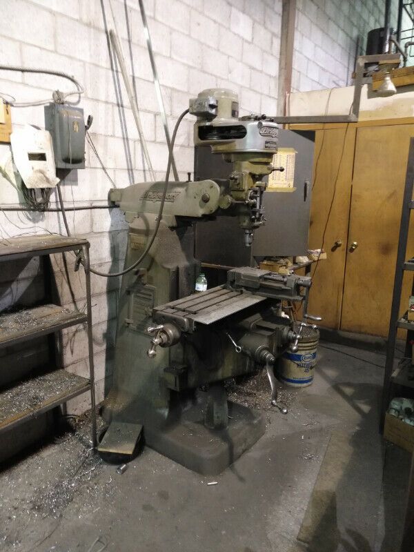

What do you think of this Bridgeport?
architect
https://www.kijiji.ca/v-tool-other/...ne-for-sale-1-400-only-for-2-weeks/1539339892
I was going to get a mini lathe and mill but Brent has talked me into looking out for used ones. Any thoughts on this one? It's probably 570 volts so Brent has advised me it'll be another $1500 to swap the VFD and motor.
I'll need need get a company to move this into my garage and even level it. I have friends but none of them have trucks or the know how to move or level one of these. Does anyone in the GTA can recommend someone/company to do this? I assume it'll be a few hundred bucks.
Millwrights to move it will be $1500. Thats what I was quoted to move a surface grinder (similar size/wt) across town in Hamilton.
It’s a great deal..... if you can do most of it yourself. And 575V is unfortunate, fixable, but costly. And no DRO so..... is it worth $5000 or can you find one for $3500 - $4000 all done up.
As I have learned (the hard way), “the machine is the cheap part”.
LOL! Thanks for that insight. How naive of me thinking the machine is the fancy part. I have friends and could rent a Uhaul trailer but something like this is beyond my ability and potentially with expensive and life safety consequences so I'd rather pay someone that can do this well, including getting it into the back of my garage.

It has the small pancake motor on the top so I would hope it to be 220/440 and then its great because as a belt drive you can more easily use the VFD to speed control and not have to change belts all the time.

If you have a fork truck moving a Bridgeport is relatively easy as you can pick it up under the ram and it is then well balanced and not "top heavy", same if you sling it for cranage properly - See Picture. I rotated the head around when I moved mine. Fork lifted onto a large dump trailer and then fork lifted off onto a mobile frame and then pushed into place.
This being said provided you are not moving it out of a basement!
I have had mine into various pieces for repairs and I can tear one down pretty quickly. If you have a good floor crane you can pull the top end parts- head, ram, turret off and the table and knee off leaving the heavy base - then you have to figure out a lift for that - could be a dolly or pallet lifter or a good sized tractor with the lift clearance. Total weight is around 1988 lbs according to the book so you can lighten up the lifts if you break it apart. I am sure @Dabbler has everything weighed out.
Somebody will correct me if I'm wrong, but I believe a Bridgeport like that is well less than 3,000 pounds, total. AIUI, most of them have a threaded hole on the top of the ram for lifting. (Move the ram and table to balance the machine.) How far does it have to move in the building? Is there a loading dock? Does the seller have a forklift or pallet jack? Willing to help?
But, if the seller agrees, you don't _have_ to move it as one piece. The head, the ram, the table and the knee can all be removed without that much effort. An engine hoist ought to be able to handle the pieces except for the base.
Yes, I would have said about 2000 lbs.

Do not forget that it has direct electrical connection - the seller may want an actual electrician to disconnect it (as in auctions).
Otherwise it feels a good price even for a beater machine. Of course you may not want a beater.
If in good condition it is worth about 2x as much.
Moving it on flat concrete is easy with some pipe rollers unless you have to move like 100m or so (then it will take a while).

@Brent H That is a great diagram! Note that it only works for the BP#1 and the smaller table models. Bert witnessed a guy blowing out the dovetails on a BP#2 which weighs just under 3000lbs. The rigging notes I saw for the larger mills is to lift from the bottom with the stabilizing straps on the ram....
Anyway, that's how Modern lifts mills using their shop cranes, the sling from the bottom, and use the ram with adjustable straps to prevent tilting.
-- to get the machine on and off a pallet jack they use lifting bars.
