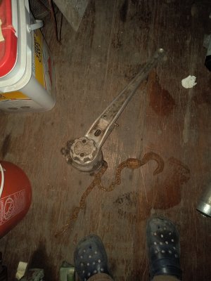

Much appreciated, and as I have the same in orange iron CM, I would hope this is much lighter. I can't lift this stuff over my head anymore, and light is important, more-so than quality.
Np, and ye this one would be lighter then the iron version but still wouldn't say it's not light I think it's a 1 ton so probly 30lbs ish with proper chain I would guess
