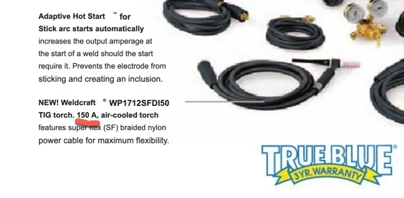

Even Miller plays games. Take the Syncrowave 200. If you look at their sell sheets it says Amperage Range, not Amperage. In other words, you can adjust the potentiometer to 200 Amps, but that doesn't mean you can get that as an output current. In fact if you look at the curve in their own literature (buried at the end of course) it even shows you how voltage dramatically drops off at 200 Amps.
For brand loyalists, it is always tempting to let your mind think, "Oh, I'm sure they are being honest" because, let's face it...that shiney new blue (or red) box looks so darn nice. But look just a little further and there is a telltale sign it ain't routinely spitting out 200 Amps: it comes with a 150 Amp torch (exclamation mark here if I believed in them).
So your instinct is right. It generally is marketing. If we were being nice we would say it's a stretch objective—kind of like my 1988 Chevy Cavalier's speedometer went to 120 MPH.
