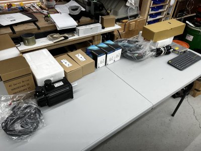

While searching for servo motor spindle motor conversions I ran across a post on Canadian Hobby Metal Workers for the following:
-Masso G3 controller and pendant
-3 axis Arizona CNC kits CX601 conversion kit, machined for:
-DMM servo motors x,y,z axis(z axis has brake). Includes the cabling for motors/encoders/setup usb cables
-DMM AC servo drivers x,y,z axis
-Meanwell power supplies, filter, capacitors, breaker
-Spare R8 spindle with belt drive pulley
-some other parts, oiler, fasteners, air cylinder for toolchanger, (see pics)
-Toolchanger and belt drive was never completed, so all of this was never used or installed.
I immediately contacted the poster, and we struck a deal. $1400 CDN plus $94 shipping.
Let the electronic assembly begin!
