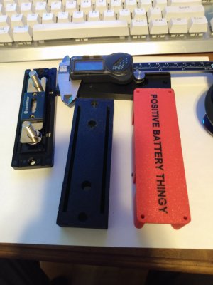

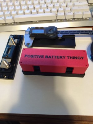

Here's a simple project I had, and what it's become.
Long story short: I wanted coffee and needed a 200 amp fused busbar/distribution box.
I bought one and quickly realized it was flimsy.
The potential for damage with a #1 electrical cable flying around in a trunk is big, and I like reinventing the wheel once in a while. So I made my own.
Fusion is at version 19 of that project, and I have a few prototype out, but I think I'm slowly creeping onto something.

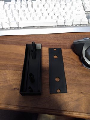

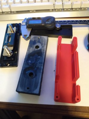

I made a shell, which had all of the critical features of my part, and a cover that could slide in from the back. Proceeded to fill with chopped fiberglass and polyester resin, and here we have a very heavy duty part, with all the features that need to be, while using playdough level skills.
Let me share a few lessons I've learnt throughout this process.

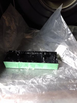

-Polyester resin create an exothermic reaction hot enough to warp PLA.
-Polyester resin does not stick well to PLA.
-Laminating fabric inside a complex mold with a bunch of small corners is wishful at best. It does good on large surfaces
-Filling that shell with fibers and pouring resin is also a bad idea.

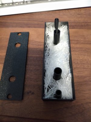

what worked:
-Making the shell longer than necessary
-long single fiber stands laid at critical location seem to do well.
-Mixing resin and chopped fiber, and use the mixture to fill the shell, then press out the excess.
-The shell needs to be double the height, because that's how much it will compress.
-Using a cap to compress all of that fiber once the mold is filled works fantastic if it has a gap or a few holes.
-Tape the surfaces of the shell to keep it clean. Resin gets everywhere.
It may be worth trying epoxy, for the smell and the heat. The work time is also longer.
Since polyester resin doesn't stick good to PLA, maybe a multi-part mold could be an option.

Nice. Because 3DP material can be off-standish to resins, this attribute has been used to make composite molds as you have shown. Still best to use a releasing agent though. Polyester is not a great choice because it exotherms exponentially with mass & very sensitive to catalyst concentrations. Vinylester is a bit better but you have to source & small quantities are less common. Both stink like crazy. Epoxy resin would be a better choice especially in conjunction with fiber materials or practically any filler. Less odor, more strength, mix ratios are pretty easy. But choice of epoxy is equally important for the same reasons, you want longer pot life resin & ideally lower viscosity but these are available. Casting urethane is even easier & may have sufficient properties for your purposes but shelf life is an issue. This site is pretty good for mail order supplies, but if you have any composite/mold questions, fire away. My hands have been soiled so to speak LOL
