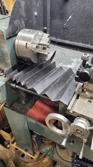

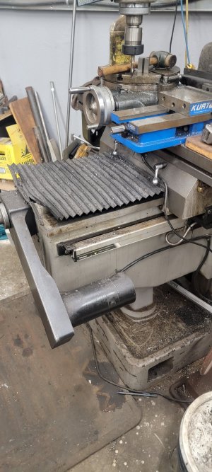

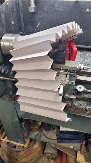

I'm pleased with this quick, cheap, n easy solution to chips n swarf from building up...
Basically, all that makes this up is an economic window blind, and rubberized undercoating...
The blind is made from a thick paper thats flexible and fibrous. I think it was 25$.
I cut it to length n width after coating it. While the peaks aren't sealed well, the coating lets the cutting fluids drip off to the side. It does require magnets to attach, and a few tig rod size weights to hold it down. It works though.

Interesting. That material reminds me of the accordion pleat material in a furnace filter only the pleats are quite a bit higher in yours.

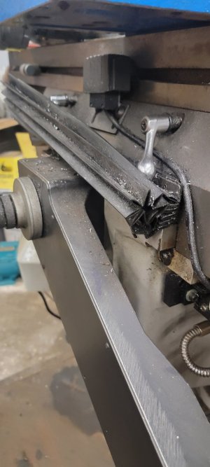

Very simple crazy glue a thin pc of sheet metal to the flap (to keep it align) bolt it on to pinch it to the surface. That's how they do it on machines.
I did my mill the between the bed and column to keep the fine cuttings out only sacrificing maybe 3/8" of travel.

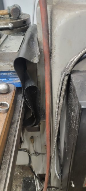

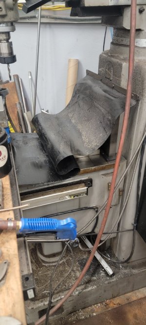

Here's mine, all the way forward vs all the way back

Between the column and table is easy. It's the other side at the hand wheel that is NFG. When the table is full forward, there is nothing there!
Think outside the box. A little "z" type bracket to give you enough space to extend the running surface (did that initial when I added the cnc) as it didn't cover the dials. Found though that I needed coverage over the servo flood coolant and a lot more scarf created quickly, so it became a 2pc sliding hard cover at that point, that extend outwards covering the servo.
Z (knee) also had a accordion cover but found it sagged and reduced space in the Y travel (remember I have limited traval here), so it also became a second 2pc sliding hard cover acting was the one fasten point for the inside point (column) fasten point of the Y accordion cover.
While I may claim brilliance, this took several months of pain staking dead ends to come up with a solution.
